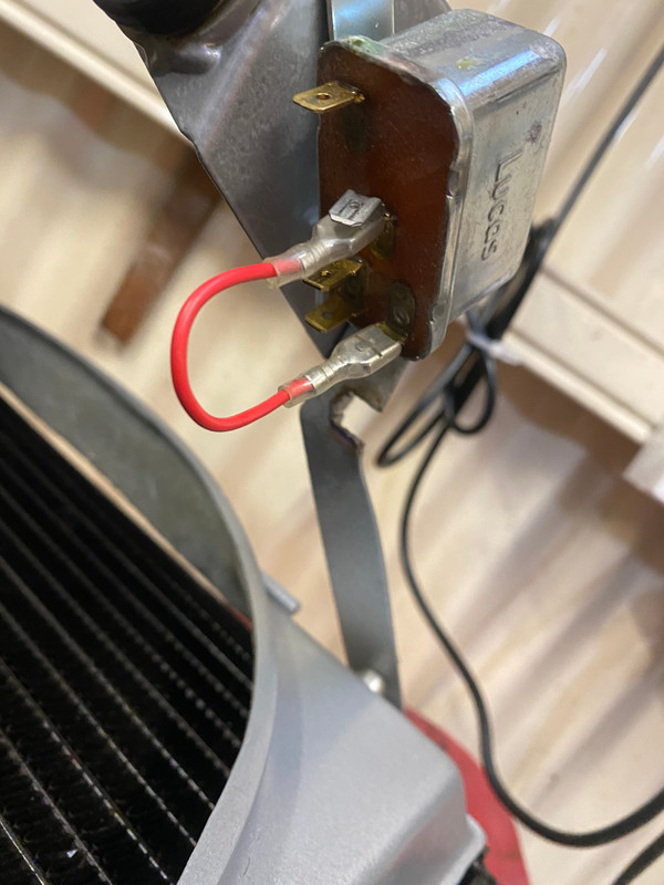

I've got my car in bits at the moment so can't show the whole wiring. Don't ask....
With some replacement relays you can connect them as per the wiring diagram but you don't get power to the switching circuit.
You need to add a skip cable.
See pic.
Maybe this is your problem.

For a three pole c1,c2,w1 relay, c2 has a double function:- it's the 12v supply which will come back out of c1 and go to the fan when the relay is activated AND it is one of the w terminals for the relay coil. That means w1 goes to the Otter switch and the other side of the Otter has to be securely grounded to the chassis. The other side of the fan from c1 needs to be securely grounded.
If you earth w1 directly, the relay should clunk and the fan come on.
The resistance from w1 to c2 will be about 65ohms. If it is infinity, it's not connected somewhere due to corrosion or a break.
You sound like you are describing a wiring problem. The resistance of the earth side of the Otter should be zero to the frame; the resistance of the relay side of the Ottter should be zero to c1 of the relay, so yes, bridging the Otter contacts should activate the relay.

Great tip to take the relay "+" feed from the fan supply.
I was going to run the "+" feed from the coil
