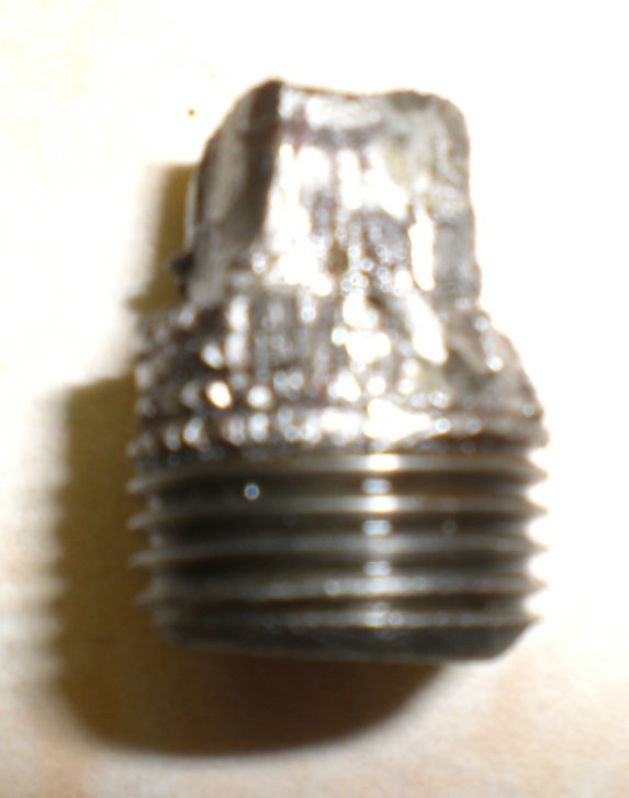

This week I gave Elle an oil change and also fitted the spin-on filter conversion. You can see from the picture that the sump plug was in a bit of a state, so I decided to replace it.
The problem is I think in the past the thread has been damaged and the new plug wouldn't tighten with the copper washer in place so installed it without and now it's weeping oil :( . Any advice would be grateful :) .

Unfortunately there is not much you can do other than buy a larger size (British Pipe Thread) plug and have the sump drilled/threaded to match, and this is difficult with the sump in place. Helicoils do not work so forget about that option. Others have tried a tapered plug but this risks cracking the sump if you over tighten it. Best plan to remove the sump and have the hole welded/filled and a new correct size hole drilled/tapped to match your new plug. This is the safest long term option.

That doesn't look like a factory drain plug. I agree with David that pulling the sump and having the hole welded and re-tapped is the best approach. I suspect that installing a helicoil would result in leakage, since these are nothing more than stainless wire having a diamond-shaped cross section. I would avoid a tapered plug at all costs. Once repaired, obtain the correct plug and washer, and don't over-tighten.

I think the plug pictured is one of the tapered ones which is most certainly the cause of the problem. The original should be parallel and have a hex head. This one looks like the plug off the differential with that square head but the size precludes it from being Jaguar.
