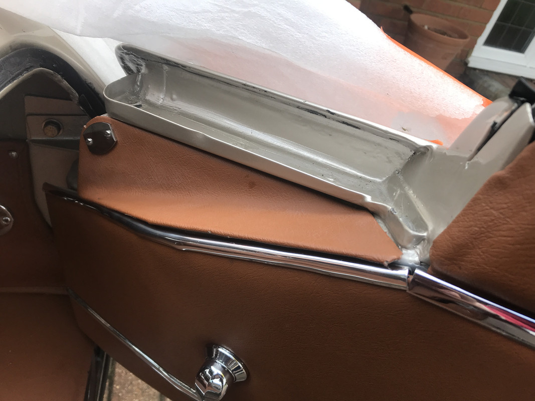

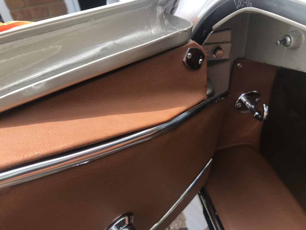

Post by Heronscourt » Tue Jun 21, 2022 8:30 pm
Not sure if you resolved this issue but here’s my solution to card fit. When I made the cards from 2mm white board MDF ( white side to the frame to help damp resistance ) I scored the back of the card on a line from the bend in the front top chrome to a point 60 mm from the from bottom front edge of the door. This enabled the the door card to bend easily to follow the top edge of the front of the door whilst allowing the bottom edge to stay straight. The chrome strip at front bottom does benefit from a slight bend but only the last 80 mm and very little. That is why the clip with two lugs holding the front of the trim is a slide fit in the trim instead of the special rivets. Otherwise the trim would keep popping off the rivet
