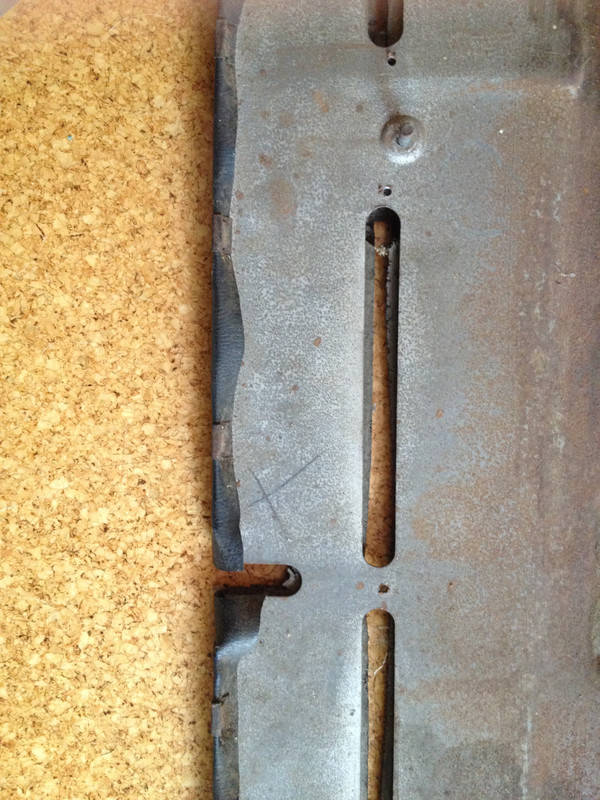

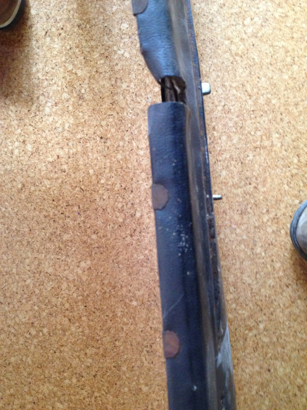

As already reported , the part number is bd10313 and there are 20 in total. They are at the front of the dash as per the photos. They are spaced evenly at about 3 inches apart.

Thank you all for your help, especially for your pictures Greg.
