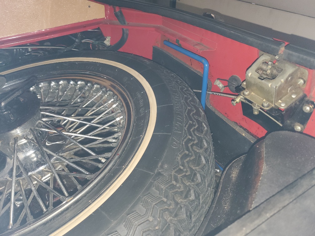

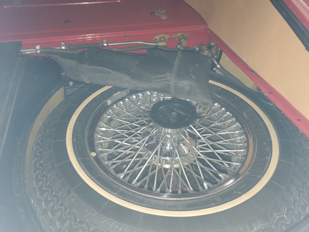

Mark, thanks, but when I store the wheel inside up, the securing device (bolt? flange?) is too long to anchor the spare tire tightly. I have to believe it was meant to be stored outside up. I've been able to store the jack atop the wheel (see picture) but I'm surprised Jaguar doesn't give directions in either the owners' manual or service manual, normally a fount of information... Currently stowing the jack handle as shown; come Spring I'll know if it rattles...

I don't think that's the correct securing bolt.

I think the wheels is the wrong way up. Securing bolt and stowage work with the wheel inside up.

Looks like the original poster has a S3 ots. You can see the fuel filter.....i think his spare is correct being this way up...the S3 has a much longer wheel clamp....and different from S1 S2 cars ........would help if original poster put his car model in the signature area......Steve

Looking at the fuel pipe connections it definitely looks like a series one Steve, so just seems to have a series three wheel retaining bolt which is too long.

My bad Steve, you're right, the filter shows its a ser 3.

The OP describes it as a 1972 OTS, kind of suggests S3. But it would be nice of him (and all others) to include this info in their signature.

I bought my 1974XKE OTS about a year ago, and could never figure out where to stow the Jack, wire wheel knock off tool, and the hammer. I tried to mount the wheel with the outside down to make more room, and the hold down bolt was too long. Baffled, I asked a renowned Jaguar expert, and he said that the spare went outside down on the six-cylinder cars and outside up on the V12 cars. That makes total sense why you guys are having this confusion. No idea why Jaguar would switch it, but then again it’s Jaguar!
