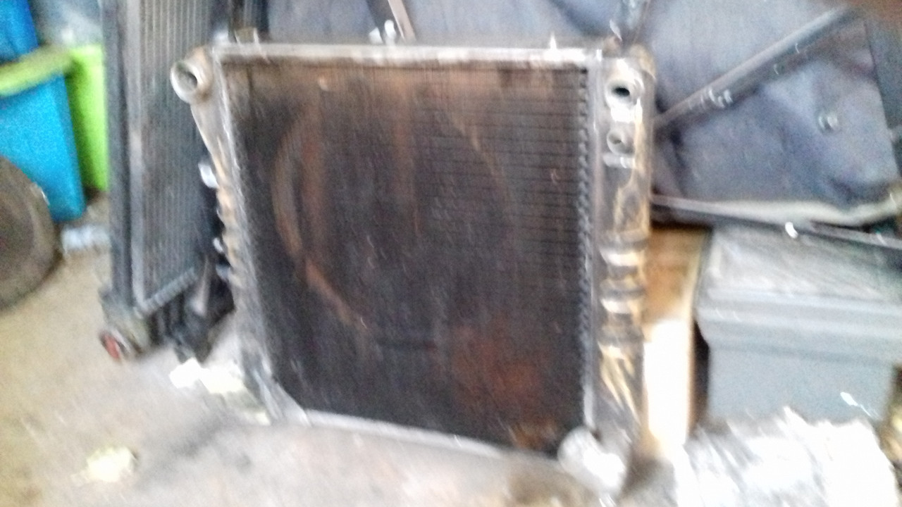

S1 4.2 Rad is out and on the bench.
Its old but seems sound.
While it is on the bench Ideally I would like to place it with the inlet/outlet pipes upmost and fill with some kind of descaler and leave for a few days to soak then flush out with water.
Any suggestions of what to use?
Eddie

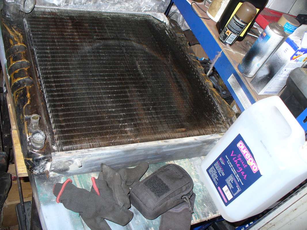

Progress so far.
Tipped just under 5 litres of this vinegar neat into the rad.
Been there a couple of days so far but does't seem to be much going on.
Do I just need to be patient?
Eddie
Thx

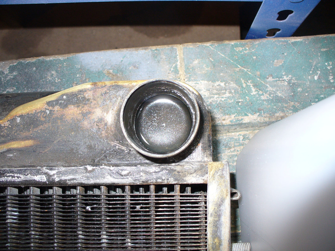

Tipped out the vinegar today- it was a bit cloudy and some sediment came uot too but not a great deal.
I didn't flush it.
From the tops of the cooling matrix I could see, there was still some kind of scale- was soft so maybe it'll flush out.
I have ordered a bottle of Kilrock. Have refilled the rad with the old vinegar and will flush and replace with the Kilrock when it arrives and let you know.
