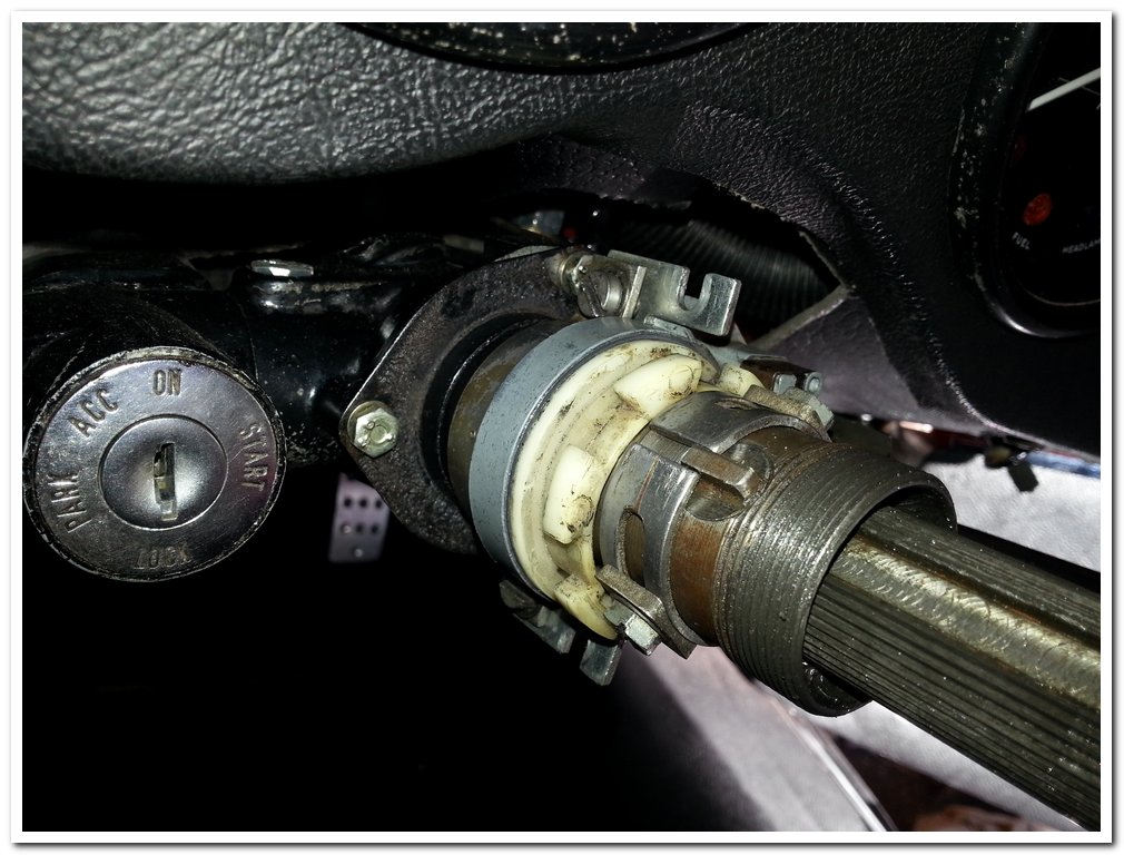

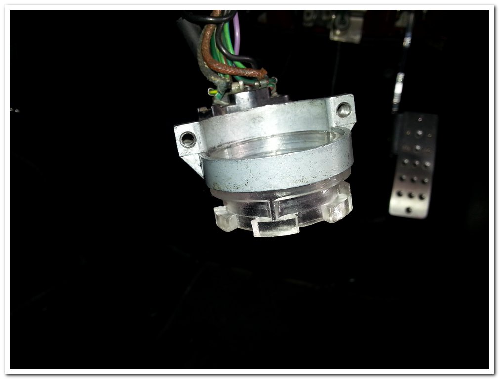

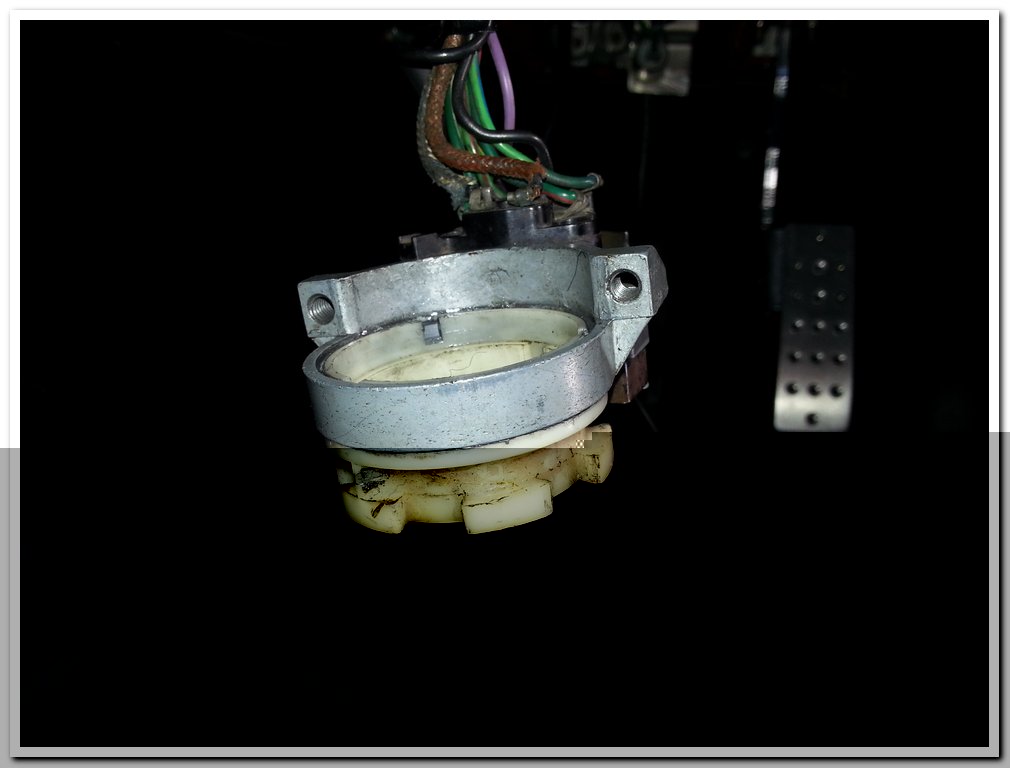

Hi all,
I received the canceling ring from Marek and installed it this weekend. The ring was sent very quickly by Marek and payment was easy using PayPal.
I had to fix my steering lock also, so two jobs done. For the steering lock I needed a shear bolt which I recently discovered SNG sells them.
The ring is compared to the original ring dimensions spot on. It is clear but you never see the ring, so that is not a problem. The material is different. The original looks like some white delrin, the new one I don't know, perhaps Marek can fill in. The original ring looked reasonably OK, some slight wear on the edges, but I had on some occasians the indicator wasn't canceling.
Hereby some pictures. The job is quite easy, but if you do dismantle the steering column for the first time use the manal and take pictures, and be careful because there are delicate parts involved like very little springs! It took me together with the steering lock some 2 hours. Todat I took her for a drive, and all worked very well. A nice cancelation after every turn. Thanks MAREK.

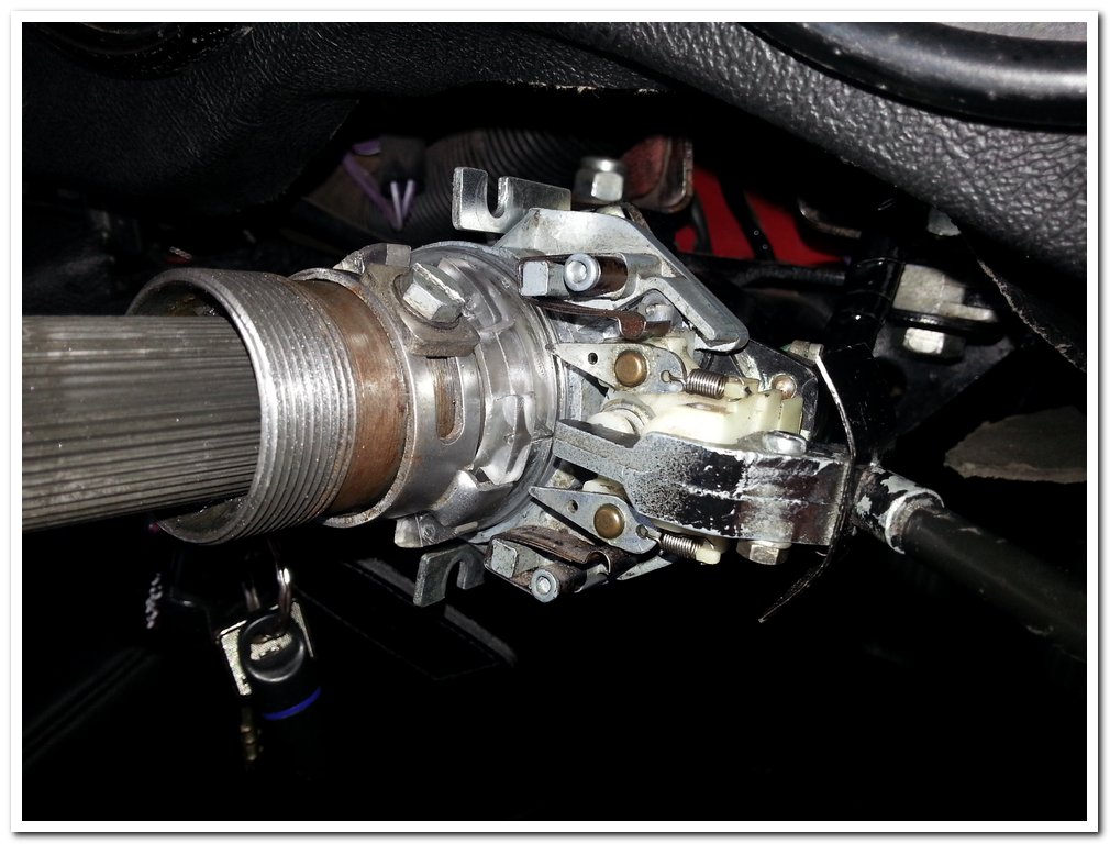

Here are the other two pictures:
