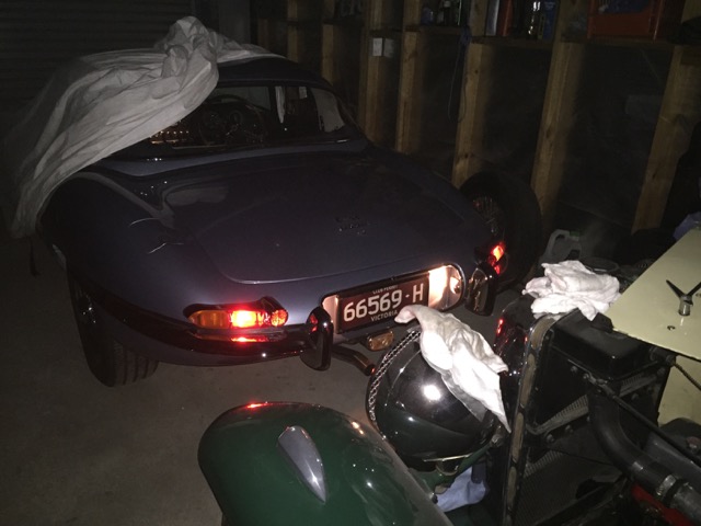

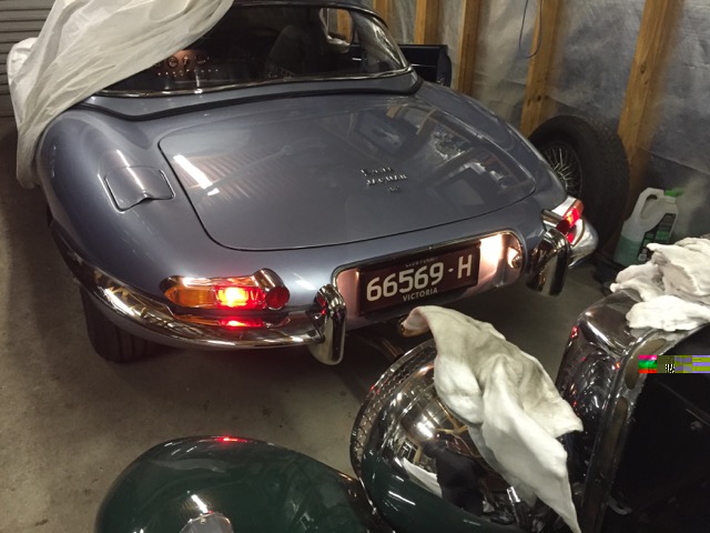

Like many E type owners, I recently was informed by other motorists that my brake lights were not working. The pressure switch was only 6 month old and now only worked under heavy braking. There has been much discussion on the forum about various 'fixes' for this problem including 'low pressure' switches and the use of additional relays, however the basic problem appears to be that the switches cannot handle the 3.5 amps required to operate the 21watt brake light globes and the contacts burn out. The fellow who sold me a new one expressed the view that these should be considered a 'service item'!
So.... having previously converted my MGs over to LED bulbs I bought some of the direct replacement BAY15D diffuser (red) 21/5 replacement bulbs from Classic Dynamo and Regulator Conversions. These require no modification to use and draw less than 0.5amps. Even on the side light setting the light is impressive and visible from a considerable angle. Hopefully the low current draw will reduce or eliminate the arcing in the switch and it will last. If people are interested I'll keep you informed as the longevity of the new switch with these bulbs.
Andrew
Photos are of side light only..... i.e. 5W equiv.
