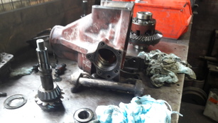

We jacked up the rear and he diagnosed excess diff backlash. He said it felt nasty.
I drove the car home, dropped the cage and removed the diff. I dropped it off at his place he will look at it tomorrow. It is a 3.51 LSD.

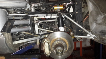

With the car in the air it allowed me a good look at the gearbox.
I removed the support, spring and cup which was full of gearbox oil. the prop was dry and I could detect no play at all in the UJs.
Gear oil was trickling down from way up then box. I put my hand up to the speedo angle drive and it was loose. I have tightened it so hopefully that has done it.
Whilst the cage is out I am going to to the wheel bearings and outer hub bearings. The inner fulcrum roller bearings look grotty, so ill do those as well.
Shocks springs other bushes are all new. Engine mounts, stabalise mount all new.

Well,
I found some of the issues.
My secret engineer took the axle to bits. One of the bearing carrier bolts was loose! This was causing the race to spin.
Also, the "factory wired" axle to carrier brackets were both loose!
This allowed the axle to move around inside the carrier!
Looking at the wire, it looks like it has been loose for the best part of 50 years!
Bit weird.
Anyway, stuff the 3.51. I am picking up a locking 2.88 tomorrow from an XJS (Salisbury)> Hope my Girling callipers fit.
All the other Ujs, bearings and bushes seem excellent.

A quick update.
Today I picked up a Salisbury 2.88 LSD from Just XJS near Derby. Seems leak free and smooth with no grinding and no real back-lash.
All those in the know don't seem to rate the Dana unit.
After work I changed the rear finned alloy XJS cover for my e type one, I had a good measure up too.
The prop flange is correct and the output flanges are the same width, as is the brake mounts for e type calipers. So I can refit the e-type shims to maintain the camber, no problem. In theory.
I have fitted it into the e type cage, wired the bolts and swapped the lower XJS mounts for the E-type ones. Interestingly the wired-in XJS mounting bolts were only finger tight too in the XJS diff! Is this a Jaguar issue?
I refitted the half-shaft/hub/shock assemblies to the cage.
Fitting all those oil seal rings to the inner fulcrums is interesting. 8x inner spacers, 8x oil seals, 8x oil seal retaining rings, 8 spacer washers, all trying to fall out. Got the hang of it the second time around. Secret seems to be leave the lower cradle plate off until the arms are correctly assembled, otherwise it is all too tight.
Tomorrow, shims, discs, calipers, drive shafts, handbrake mechanism, shock upper bolts.
Then oil in, cradle up, cradle mounts shimmed and bolted, prop flange, hand brake, brake line connected, trailing arm bolts and safety bracket.
I found the easy way to fit the trailing arms into the cup is
1 Support the body.
2 Support the hub on a jack with the bleed nipple removed.
3 Drift out the lower shock arm,
4 Jack the hub assembly up into the body.
5 The lower trailing arm mounting point will now get closer to the cup, allowing it to just pop on so you can add the bolt.
6 Drop the hub, reattach the shocks-done.
Took me a while to figure that out last time.
Then, bleed brakes wheels on. Off we go. Maybe.
