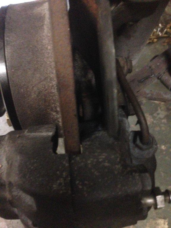

Sorry I probably didnt explain very well. Now the calipers have been fitted back on and the new wire hubs are in place the disc doesn't sit centrally in the gap in the caliper (in the vertical plane).
There disc is nearly touching the body of the caliper on the inboard side of the car and quite a large gap exists on the outboard side - almost to the point that it would bind on the disc when the wheel is rotated. If anything it would appear the caliper needs to go further inboard or the disc come further outboard to locate the positions centrally.

What you describe makes me think that either the discs are not right, or the hubs. If you compare the hat heights of the old vs the new discs and they are the same, and you've re fitted the calipers as they were before you took them off, then it sounds like you might have the wrong hubs, or someone changed the uprights (which works out to the same as having the wrong hubs).
Posting a picture might help.

Hi Bernie......can you explain exactly what new parts you have put on and what original parts have you reused...also are you sure tne discs were central befor you started the change

This shows the disc off centre. I have only added new bearings and hubs for wire wheels. I have spoken to MWS re hubs and SNG Barratt re bearings and both are correct. Mysterious!!

Hi Barrie.....well tbere you go...if the discs were central befor? it can only be the bearing or hub......even though tbe suppliers say they are correct it dosent mean that they are the same dimensions as what you have taken off....so the easy option is space out the caliper

Take all the new bits back off and measure them, comparing them to the old bits. Somewhere you've lost about 1/4", so you should be able to pick this up with just a 6" ruler. I would space the caliper back for the sake of 3/32" or less, but 1/4" would make me want to see what was wrong.

My only thought was did any spacers/shims drop out when you disconnected the callipers ?
