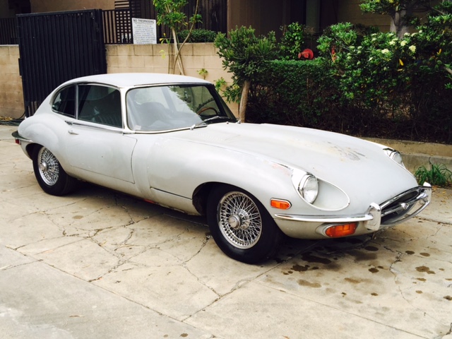

#8 Re: S2 Taillight Housing Colour
Not a million miles away from this then.
eddiecross
Topic author - Posts: 223
- Location: Egham
#9 Re: S2 Taillight Housing Colour
Hopefully. Take a bit of work though.
Whens It's finished. Thx
Eddie
Eddie
