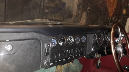

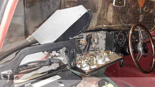

Well,
I started by 6pm, by 8pm they were out.
I removed the dash top and glove box.
Dash off.jpg (101.17 KiB) Viewed 15565 times

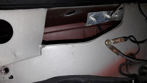

This revealed 2 hand sized apertures. I removed the wiper spindle to make the LHS hole a little larger.
Spindle off.jpg (75.61 KiB) Viewed 15565 times

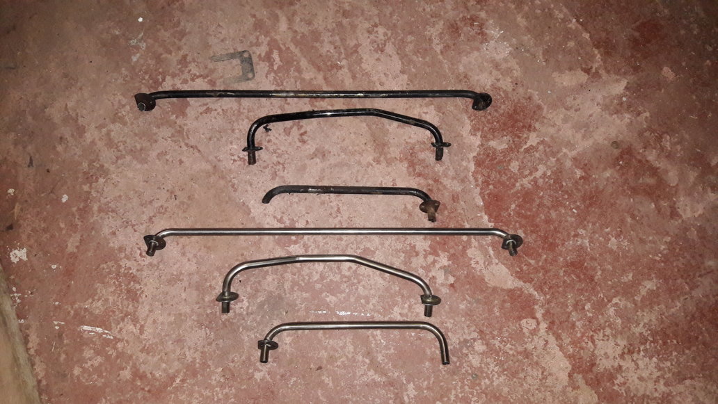

The top two short pipes are easy to take out and I would imagine, easy to refit.
My heater valve was welded onto its pipe, I cut the pipe with a hack saw to release it.
The long bottom pipe lies in the Mariana Trench. Even removing the heater box wont help access.
I just needs patience.
I drilled a hole in the RHS of this pipe and tied in string, prior to tapping it through the bulkhead lightly with a hammer.
If you can get your hand through the LHS wiper spindle hole, you can touch the pipe at the bottom of the trench.
I then had to enlist the help of my 11 year old who slid it out through the center hole where the flasher unit lives. Eventually.
He had to waggle it around the gearbox support obstruction in the middle of the dash void.
So I can now refinish that area of the bulkhead prior to refitting the new pipes.
Well worth it, one of those jobs easier to understand if you just get on with it maybe.
Looking at the condition of the pipes I removed, they could have failed at anytime I think.

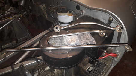

by Vegard
Maybe this is sacrilege, but I ended up like this...,,
The pipe is from a BL car, so aaaaalmost in family :)
