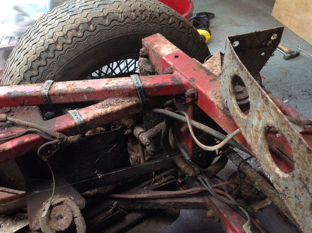

Hi.
This is my first post on this forum. I am almost at the end of a complete restoration of a 1967 rhd fhc but need some help in the routing of the cable from battery post to the starter motor. I looked at a OTS at the Duxford auction last week and it appeared to go all the way up to the picture frame before heading back via the right hand frame, but it was difficult to be sure. The shortest distance would be in front of the bulkhead but none of the cars I’ve had a chance to look at seem to do that. Also is this cable cotton covered or just black pvc?

#2 Re: Starter motor cable routing
Post by abowie » Tue Mar 26, 2019 12:29 am
You are right. Down along the round diagonal tube of the left engine frame to the picture frame, across the top of the bottom rail of the frame and then back to the starter along the bottom rail of the right engine frame.

Posts: 9150
#3 Re: Starter motor cable routing
Post by mgcjag » Tue Mar 26, 2019 8:34 am
Hi Terry...As Andrew says above......Also cable is not cotton covered just black plactic/pvc.....Steve

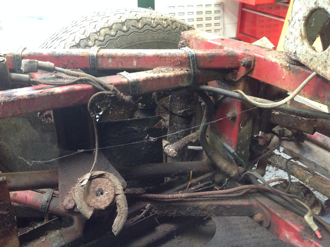

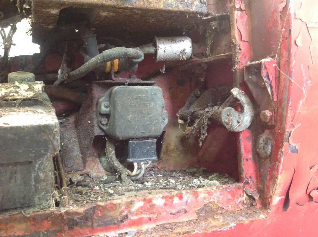

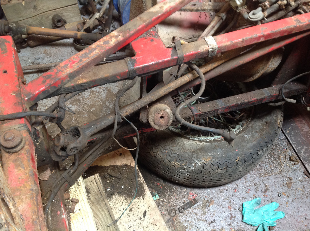

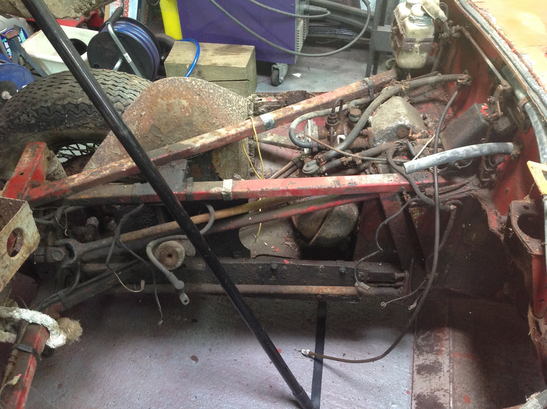

Jeremy66
Posts: 105
#5 Re: Starter motor cable routing
Post by Jeremy66 » Tue Mar 26, 2019 7:42 pm

vaf123
Posts: 6
Joined: Sat May 20, 2017 11:47 am
#6 Re: Starter motor cable routing
Post by vaf123 » Wed Mar 27, 2019 12:26 pm
Thanks for the pics. I have also been able to sort out a couple of other issues with regard to the positioning of choke and speedo exits from the bulkhead. All very helpful.

Mich7920
Posts: 777
Location: France
#7 Re: Starter motor cable routing
Post by Mich7920 » Wed Mar 27, 2019 1:14 pm
Hi Andrew and Steve,
Could you confirme
" Down along the round diagonal tube of the left engine frame to the picture frame etc etc"
The pics don't show this.

Posts: 4561
#8 Re: Starter motor cable routing
Post by PeterCrespin » Thu Mar 28, 2019 9:28 am

Jeremy
Posts: 801
Location: West London
#10 Re: Starter motor cable routing
Post by Jeremy » Fri Mar 29, 2019 8:37 pm
On my car the cable runs along the underside of the upper member of the picture frame. This is how it was when I got it and there was nothing to indicate that it wasn't like that originally. When I replaced the cable during the restoration I followed the same route. (I also sleeved the cable in braided sleeving on Julian Cactusman's recommendation for added protection).

vaf123
Posts: 6
#11 Re: Starter motor cable routing
Post by vaf123 » Wed Apr 03, 2019 9:43 am
For the record and after having had the opportunity to examine a couple of cars, I have gone for under the top rail, along the bottom of the upper picture frame rail, and along the upper inner rh rail. This way all the electrical cables are kept separate from hydraulic pipes as far as possible and at least makes sense to me.
