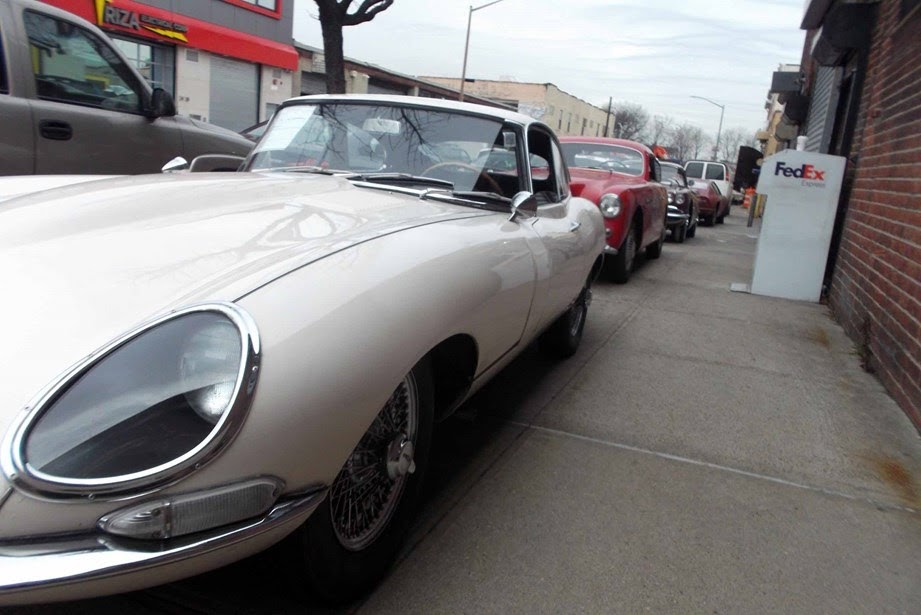

You could also try giving Hutsons a call as I know they painted this Cream/OEW s1 in the last couple of years (after which Dave White added his artwork)...

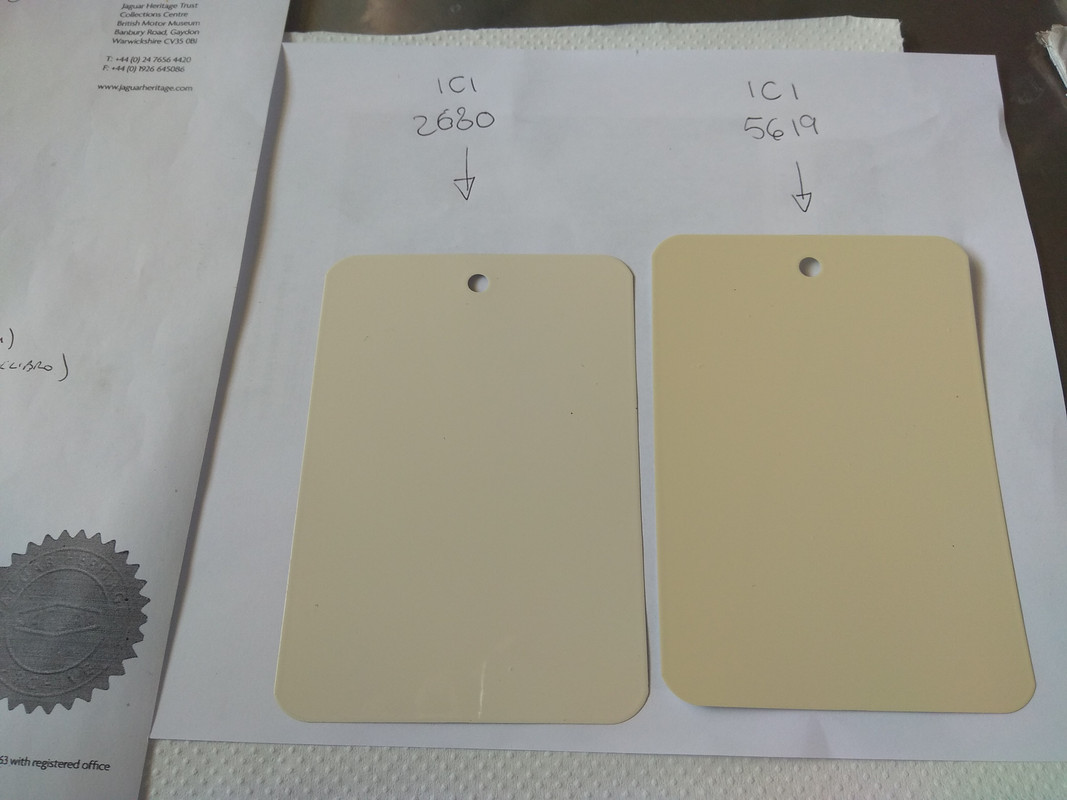

Good morning to everybody. I have the same problem for my Jaguar 66: cream or oew. I made the request to the heritage and they gave me the following codes. The correct one (cream ICI 5619) is too dark to respect the original car paint, see below. Actually the real cream seems to be pretty strange. The other option (old english white ICI 2680) is lighter and belong to ancienter jaguars (from 56 if I am not wrong). It is still "darker" to respect my original car color, but better than cream. The problem is that now the old paint has been completely removed. Unfortunately no exhaustive comparisons can be done anymore!. Have you got some suggestion? I would choose the correct paint, but also something visually nice.

Alessio (alias elcinghio, which all Ducati owners know means "the belt") didn't get much of a response, and I'd like to float this to the top again.
His Heritage information indeed seems contrary to what I had understood, which was that "Cream OEW" changed over the years and wasn't a constant from 1961 to 1967, yet certainly was ICI 2680 at some point, including when my car was built in 1962, whereas Jaguar have stated ICI 5619 - that is clearly different - for the whole period.
I'm repainting most of my shell (outer only) at the moment and can't find any paint supplier in Montpellier that knows what ICI 2680 is. Maybe the Hutson suggestion of P420-2680 will help ..........
Any other Cream-OEW owners with European paint experience, please ? :helpsign:
