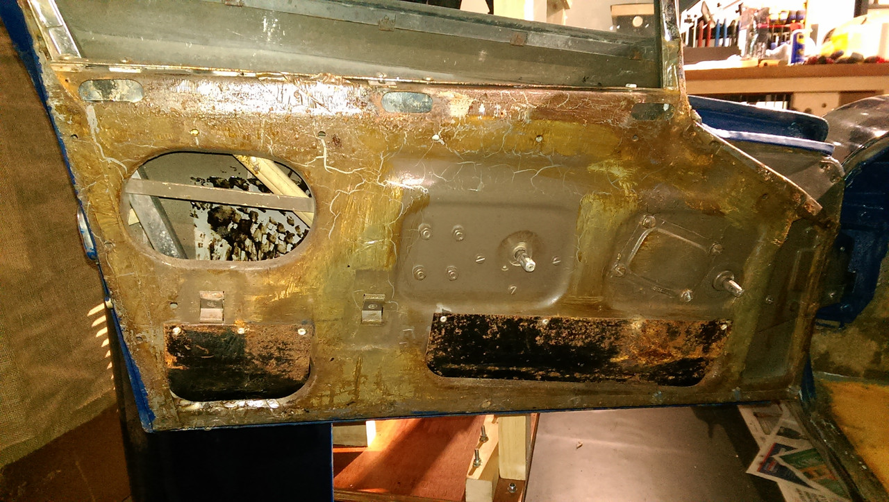

Do the covers look like this? Water deflectors to protect the back of the trim panel. Not sure when they were first and last fitted but not all Es have them. They do make working on the door mechanisms a pain.

#6 Re: Passenger door remote lever will not move. 66 FHC
Jeremy, thank you for the photo. The riveted panels are exactly what is on my 66.
I drilled the rivets on the larger panel and was able to remove the mechanism. Added machine oil and the handle is turning again.
The riveted panel was rusting on the inside and also the door skin in one place where it touched the panel. Maybe dissimilar metal corrosion. The riveted places have a black sticky goop or gasket keeping the panel separated from the door skin.
I'll repaint the panel and then see if the mechasim goes back in as easily...fingers crossed.

#7 Re: Passenger door remote lever will not move. 66 FHC
What's your name? Can you try to enter an auto signature that will appear at the bottom of your posts? More friendly that way...
Those panels and the bottoms of my doors were in a terrible state on my car, all so badly rusted that I got new doors during the restoration. The panels are an inelegant attempt to address the problem of poorly fitting window frames and seals. I thought about making up some replacements (nobody seemed to sell them) but in the end I didn't bother....I fitted some superior scraper seals for the drop glass, and new plastic membrane behind the trim panels.
