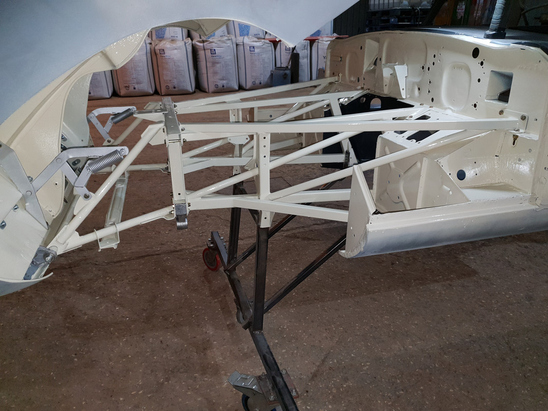

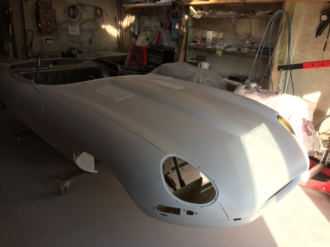

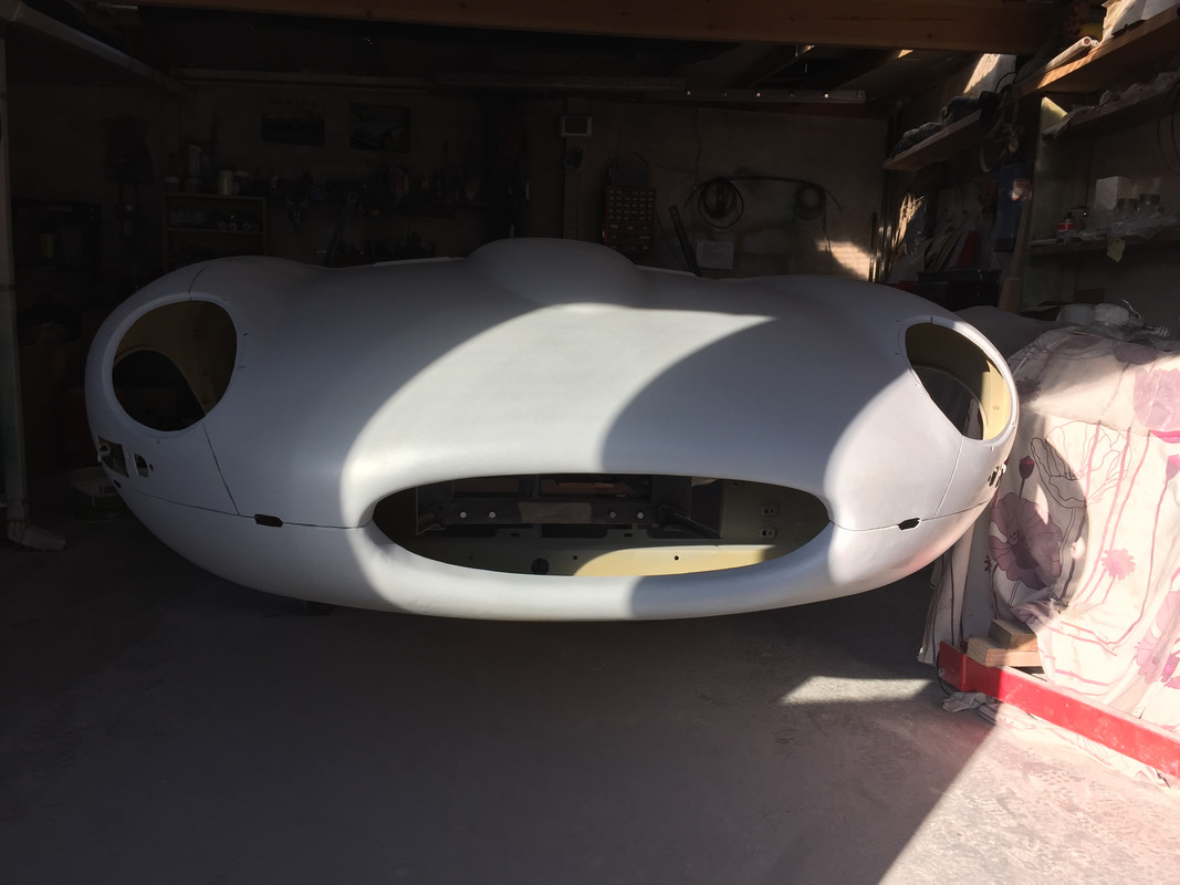

A picture paints a thousand words so I've attached a few pictures showing the Monocoque Bodyworks series one headlamp flanges all fitted (it was a series 1.5 with open headlights) and to show the general state of play today.
