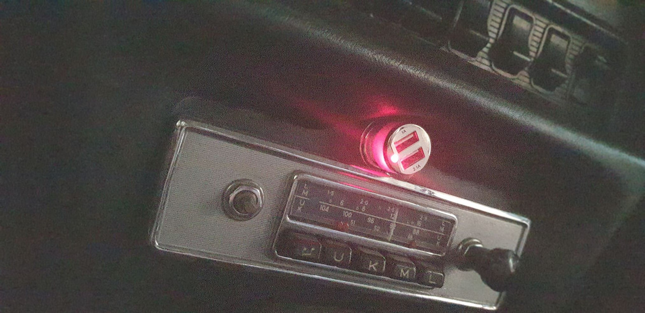

#16 Re: Phone / sat nav adaptor
Post by Polse7317 » Mon Mar 04, 2019 6:28 pm
Here is what i have done:
:salute:
