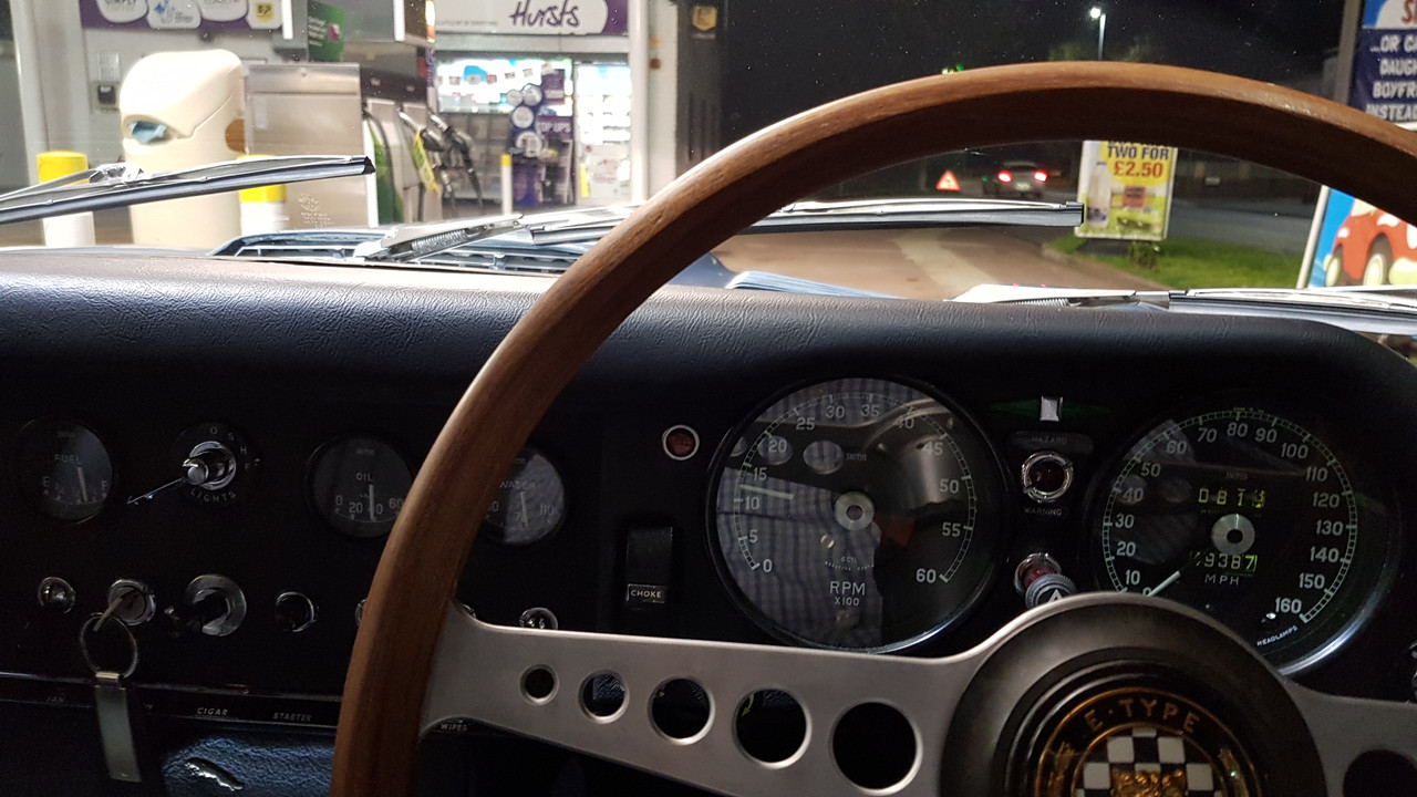

My wheel isn't varnished. I would prefer a varnish finish to it. Any recommendations on what I should use?
S1.5 FHC 4.2 OSB 1968
#19 Re: Varnish for series 1 steering wheel
Just two points- First I always use a satin finish on wood. When you look at a gloss finish you see yourself. When you look at a satin finish you see the wood grain. Second, I use a gel urethane that I wipe on and then wipe off. I do this six times to build up a nice finish.
