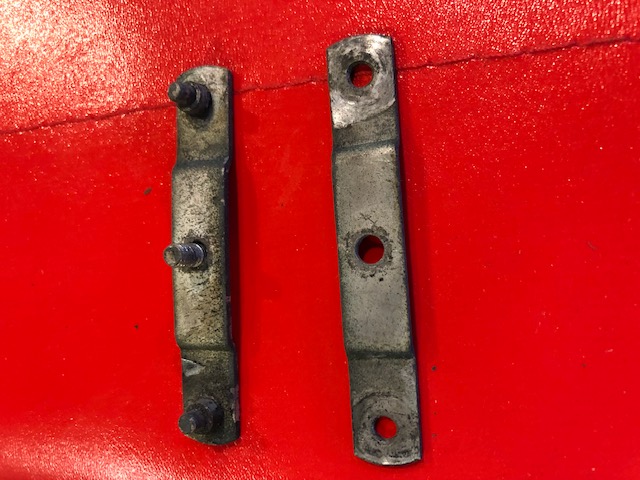

I am new to the world of E Type ownership having recently acquired a BRG 1962 Series 1 FHC in left hand drive form. I am in the process of a conversion to right hand drive using a kit of parts purchased from Hutsons. All seems to be going pretty well so far but unfortunately I have found 2 parts which I can't identify and for the life of me I cant recall where I unbolted them from albeit I'm sure that they came from behind the dash; not that this helps!! I was hoping that someone may be able to assist? I've tried to attach an image but may have got this wrong owing to my unfamiliarity with the forum, apologies if this isn't attached.

I cannot be certain, but they look like part of the wiper linkage to me

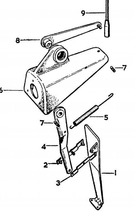

#3 Re: Unknown Parts
Parts C18478 (2) and C18482 (3).

Graeme, the accelerator pedals are different LHD to RHD which will help explain why these look different and the lack of cut out in RHD carpets.
Have you got the SNG Barratts excellent catalogues for the E Type with all parts very clearly shown? SC Parts also have clear parts catalogues. These will help you identify parts and differences.

The throttle pedal as purchased was as per the diagram which clearly details the parts in question, so many thanks for this, Clearly no longer needed as the right hand pedal assembly is completely different.
The cut out that I refer to is in the left hand footwell carpet and was necessary to fit round the throttle pedal which is secured to the floorpan. This is now redundant and so the carpet needs to be replaced.
