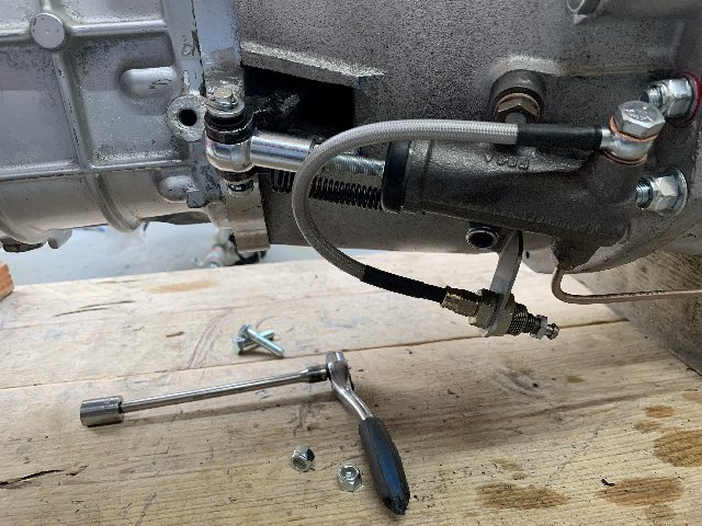

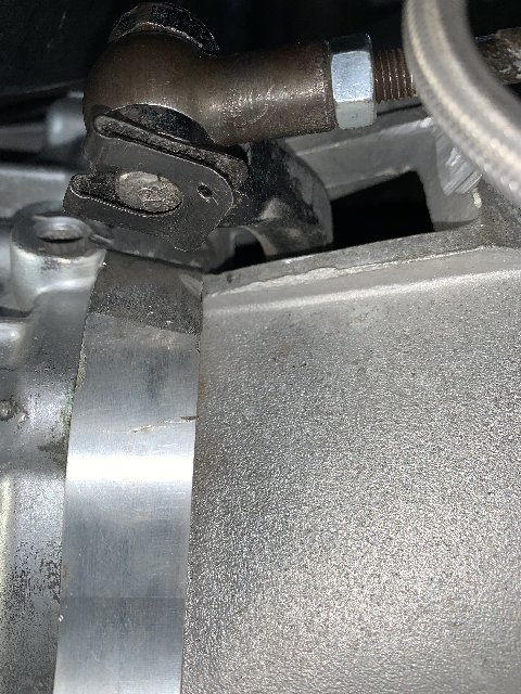

Guys I have spent a few hours under the car taking the exhaust off as stage one to remove the engine and while I was there I took a couple of photos through the inspection hole under the clutch. I don't have an endoscope so this isn't great but it does show what I have.
The thrust bearing appears to be the correct one, with the longer reach. I also took a few pics of the lever and hole again and have removed the spring for a better view. Its now on the ramp so I could take one from another angle.
What do you think? I have ordered another Bearing from SNGB and a new push rod as mine is quite scabby!
I previously bought a 1" slave cylinder from Rimmers as suggested by someone in a previous post so I may try that first as, to my eye's at least, it doesn't look as bad as I first thought. The activating arm looks about on centre point so its efficiency should be OK I would think? it looks worse from the outside because of the bend in its shape as it leaves the bell housing.
Can I ask your professional opinions again? Sorry to be a pain but obviously its a big decision!! Do you think it looks OK?

Hi Rory, unfortunately I took it off before I checked that, but it must be ridiculously close even if its not actually touching. The trouble is thats going to give no room for wear so I think I need a better solution.
To make matters worse the 1" slave cylinder I bought is u/s, although it looks the same, the lugs are too far forward and it wont fit, back to square 1.
My worry now is that if I do have the correct thrust bearing, and there isnt a longer/thicker one available, what can I do to fix this?
I guess shims behind the flywheel might help, but this is probably dangerous and a bad idea and may cause problems with the starter ring. Or a new flywheel? I only skimmed mine but I dont know how much material the PO took off with his angle grinder??

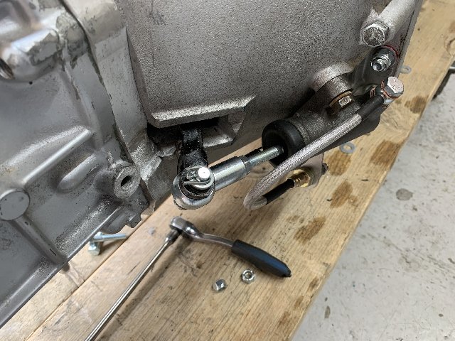

This is the slave and fork position on a 4.2 box.
How does it compare to yours?

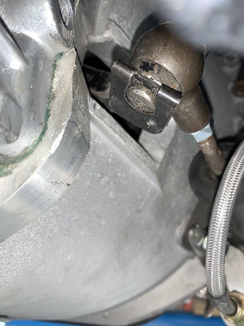

I too seem to have a problem with the Borg & Beck Clutch on my 3.8 engine.
When I assemble my clutch to the flywheel, the diaframe of the clutch gradually pushes in util it's flat, or even concave.
When the gearbox is in, the fork is much further outward - then on your photo. I can disengage the clutch using a bar, but it's really hard even with a 1 meter bar.
Could this be the clutch problem? It seems as though the clutch steel plate is too thick and either skimming hte plate would help. But it's a new clutch!

Hi Tadek....im assuming your photo is the lower one.....normaly the fork should be approx in the center of the square hole.....as mentioned in above posts have you used the correct release bearing...Steve
ysmalkie
Posts: 550
Location: Poland
Poland
#39 Re: Clutch hydraulic gearing
Post by ysmalkie » Sun May 03, 2020 12:49 pm
Yes, it's the tall one, as on the photos above.
