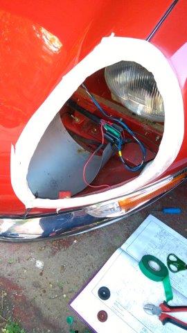

First job was to remove the existing S1 Fan Cowling (This is no longer required), Kenlowe Fan and the wiring to it which unfortunately fed through the compartment under the LHS headlight that the bonnet multi-pin connector wires pass through. So LHS side Headlight trim, glass and sugar scoop very carefully removed for access and all existing fan wiring removed.

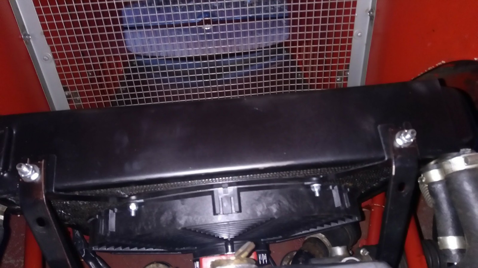

The Revotec fan came with some zinc plated mounting brackets, these were painted black to match existing radiator installation. Fitting was straight forward, I had taken the radiator out, but there is no need to, just drain the system, undo the bottom radiator mountings, lift up and slide the slotted lower mounting bracket under the radiator fixings.
I decided to wire the fan using the existing Kenlowe capilliary type thermostat switch and cabin override switch. Keeping the Revotec thermal switch for install at a later date if required.
The fan is easy to fit and a vast improvement over the old Kenlowe, bringing the engine temperature down much quicker once it is turned on.

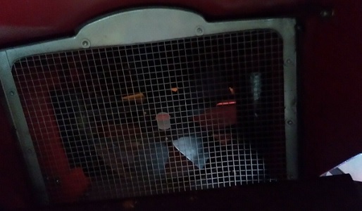

I finished 99% of my restoration last October (still one or two jobs to finish before I can say ‘job done’) so the paintwork under the bonnet is not too shabby. It could do with a clean after oil leaks/coolant hose failures and 350 miles of running-in dirt. I’m also in south lincs, so might see you out and about at some point!

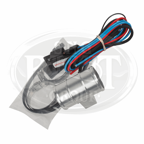

I'm interesting as well in the radtec thermo switch kit as it allow to switch on the fan with the temperature you set up. Do you know on which hose it should be fitted for being efficient knowing that this is a 38mm internal diameter ?
I have a cool cat as well this is really efficient in both flow and power consumption.

The fan switch you posted a picture looks the same as supplied in the revotec kit. It fits in the top radiator hose on the LHS. As i said i am still using the kenlowe capillary thermostat inside the same hose, with the kenlowe manual override switch and keeping this as a spare.
I heard good things about the coolcat fan but generally from owners in other countries I could not find a supplier of these fans in the uk.
