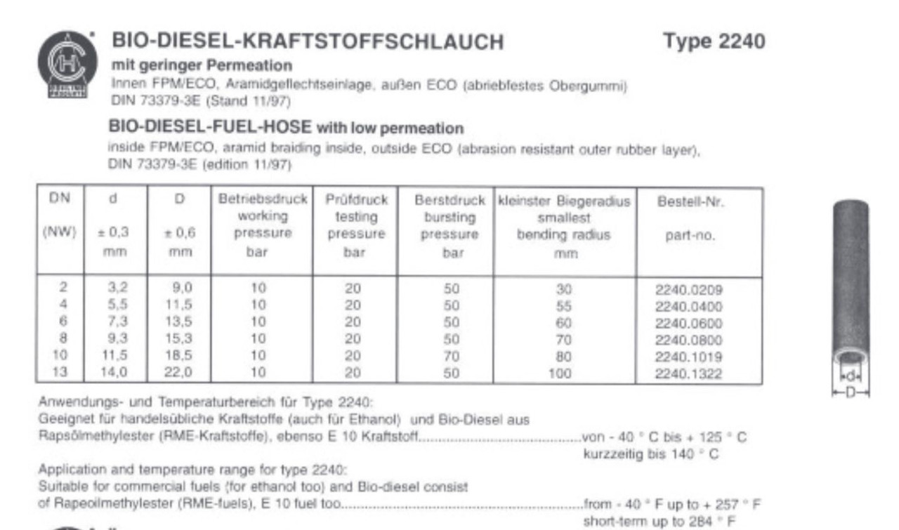

I have changed all my fuel hoses to Cohline 2240.

Found I had bought some more 2240 for another job so I have some 5.5, 7.3 and 9.3mm bore. Not silicone flexible by any means but quite easy to achieve the minimum bend radii quoted in Cohline's spec sheet above. Less effort required than the equivalent size but thicker walled R6 and R7 fuel hoses I have.
There is some initial set from storage coiling so if you wanted to change direction more than once the force to overcome the set would have to be added.
