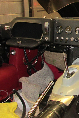

Post by baldyz1 » Sun Nov 22, 2020 6:45 pm
Sorry for not coming back earlier did not seem to get a notification of your kind posts.
Is it possible to get a picture of your cable entry points. Just to make sure mine is correct. Trimmer seems to think there is too much bulk compared to FHC.
Would you have had as much cable as before you trimmed as you see in my pic;
Many thanks
Chris

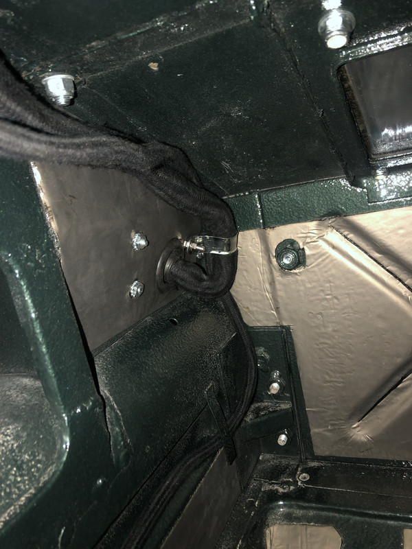

#5 Re: S1 2+2 wiring loom and footwell
Post by paulsco » Mon Nov 23, 2020 11:25 am
Hi Chris,
This is a 65 FHC, but I wouldnt have thought it would be that different on a 2+2.

#7 Re: S1 2+2 wiring loom and footwell
Post by paulsco » Mon Nov 23, 2020 11:37 am
A couple more:

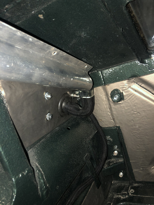

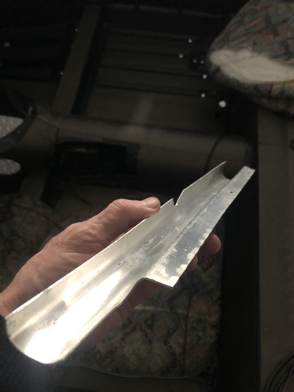

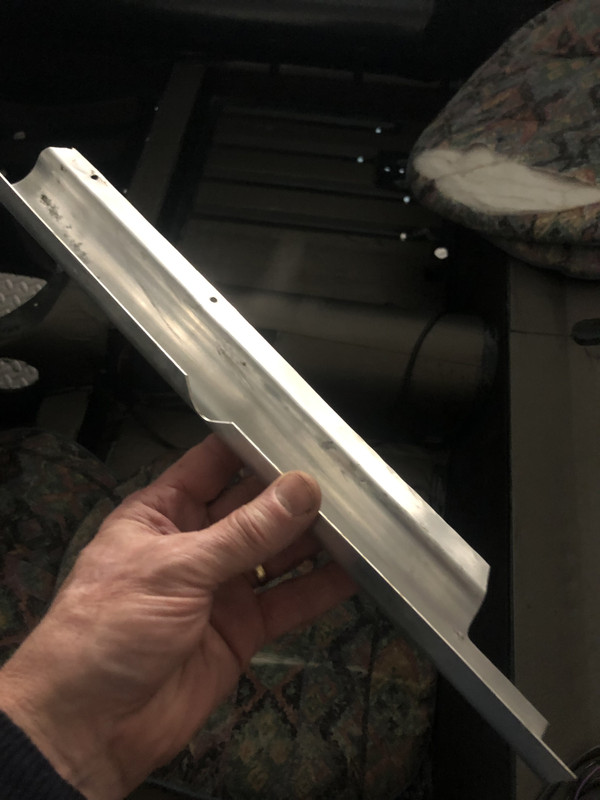

Post by Robbiee » Thu Nov 04, 2021 8:22 pm
Just to add to the thread …
This is my March ‘62 3.8 left footwell showing the P clip in position(bit of a bugger) and the aluminium’s conduit which I believe is original . It has a triangular cut out at the midpoint that clears a frame bolt that comes through the body and a cut out at the top end to allow access to the bullet connectors
