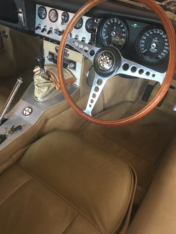

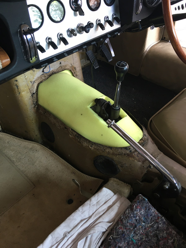

Today I fitted home-tailored gearbox insulation foam and then the gearbox cover along with the rest of the interior. Bonnet goes on tomorrow and hopefully that’s job done!
Note my period correct fibreglass glove box picked up at Beaulieu last year. That was a fiddly job. Sometimes one needs little hands like Mr Trump!
Pete
61 E-Type FHC Opalescent Golden Sand - now sold 😕

1. How did you shape/create the gearbox insulation?

#12 Re: Nearly there
Post by peters3103 » Thu Dec 03, 2020 8:42 am
Hey Robbie,
I simply used a piece of 1” thick, medium density, upholstery foam and cut it to shape tucking a few inches down the sides and up the front on the bell housing.

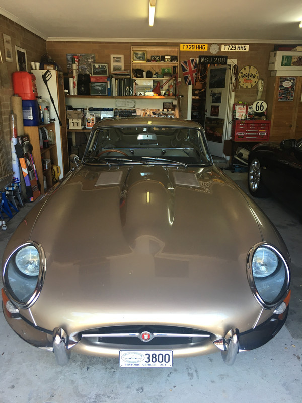

Today I re-fitted the bonnet along with refurbished balance links, newly cad plated catches & locks etc. and number plate. Went for a short drive to get petrol and air in the tyres. Surprisingly tyres only lost 8psi each after 12 months. Indicators not working. Yes I forgot to put the big plug into the bonnet socket!
Things to note:
The clutch is dragging a little unless pumped a couple of times to select gears while stationary. I suspect there’s still some air in it.
The front suspension has settled to the point of exhaust scraping going into my garage. Measurement now is approximately 7 3/4”, about an inch too low. Will need to adjust reaction plate up. It’s set at its lowest at present.
Steering wheel off centre but still needs full wheel alignment.
Having driven it twice now I can’t recall checking the speedo to see if it’s actually working and whether the needle is steady after fitting a new cable. Shows how much attention I paid to my speed!
Oh, and success with the handbrake after a bit more research. I had the cable adjusted too tight not allowing the ratchet mechanism to work properly. I screwed the adjuster bolt into the block approximately a third of the way and presto my handbrake holds the car on a slope at about 6-7 clicks at the lever. Good news!
