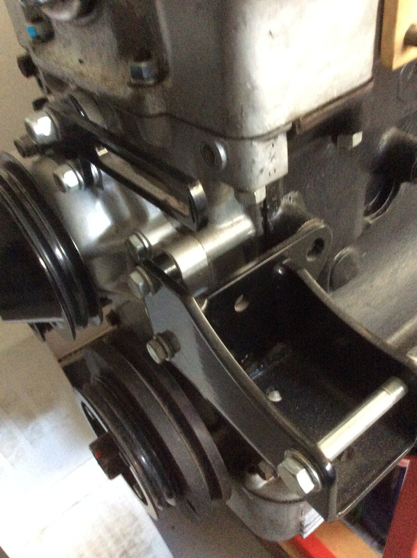

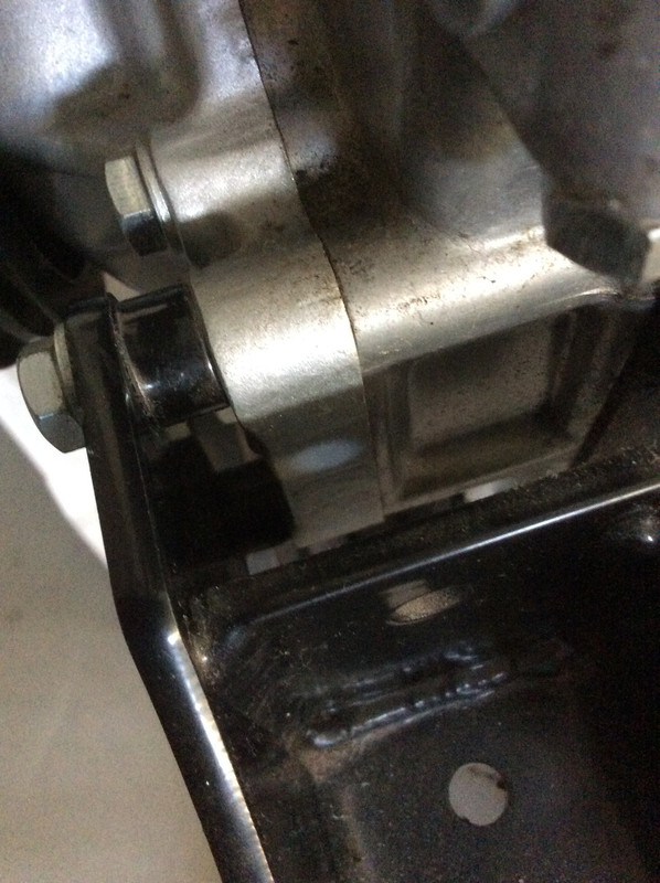

It may not be related, but there are two “distance pieces”, part number C 24424, between the Alternator Bracket and Water Pump. They look a bit like the two as the third set.
As seen on my spare engine :-
