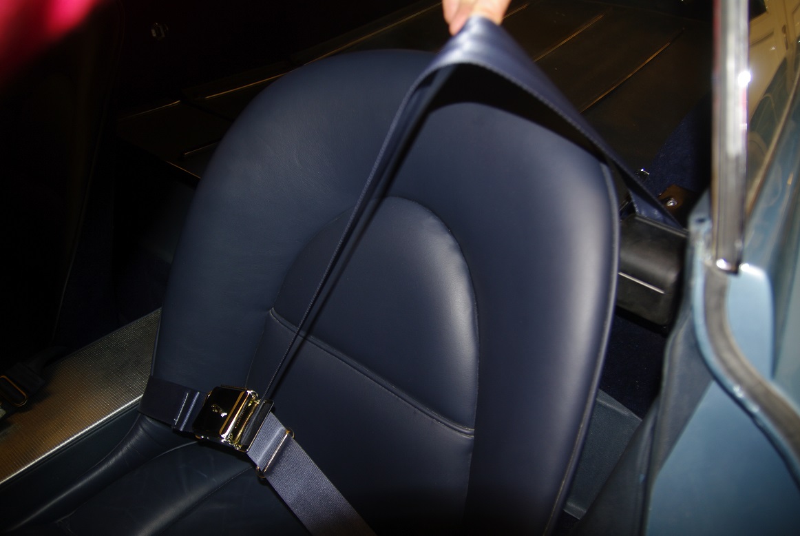

I've recently purchased a set of inertia reel seat belts for my 62 FHC from Quickfit Safety Belts (not the low-rent auto repair shop) and went for the full set of options. While not strictly a period fit I think the convenience of inertia reel belts is worth the deviation from standard. They weren't particularly cheap, but then, nothing is for an E Type. I haven't got them fitted yet (soon, I hope) the quality seems excellent and they look really good against the new interior trim (Jaguar grey webbing and chrome buckles against the red interior).
Three point static belts were an option and your car will probably have the three mounting points hidden under the trim.
I have no connection to Quickfit other than as a satisfied customer. They are a pleasure to deal with and turned around my order in just a few days.

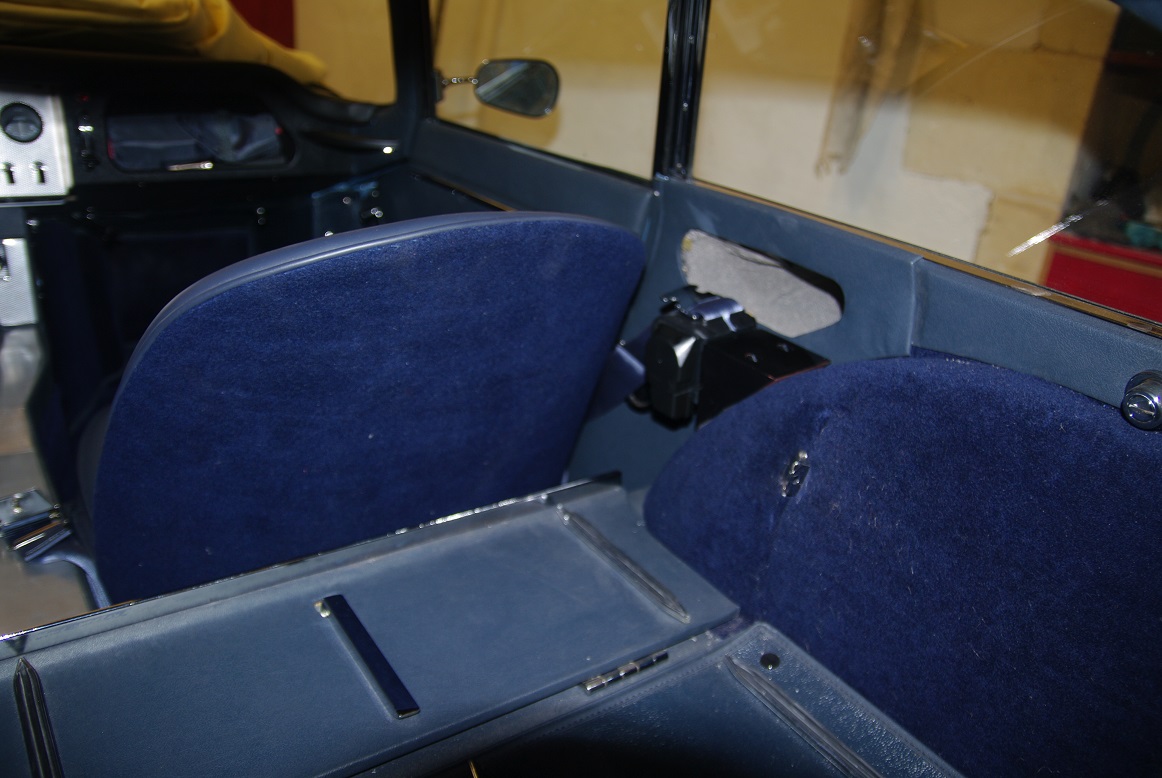

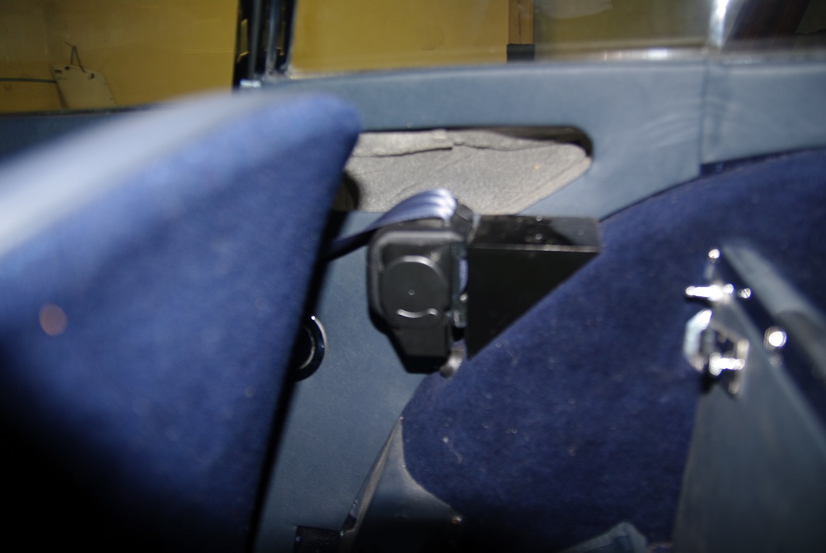

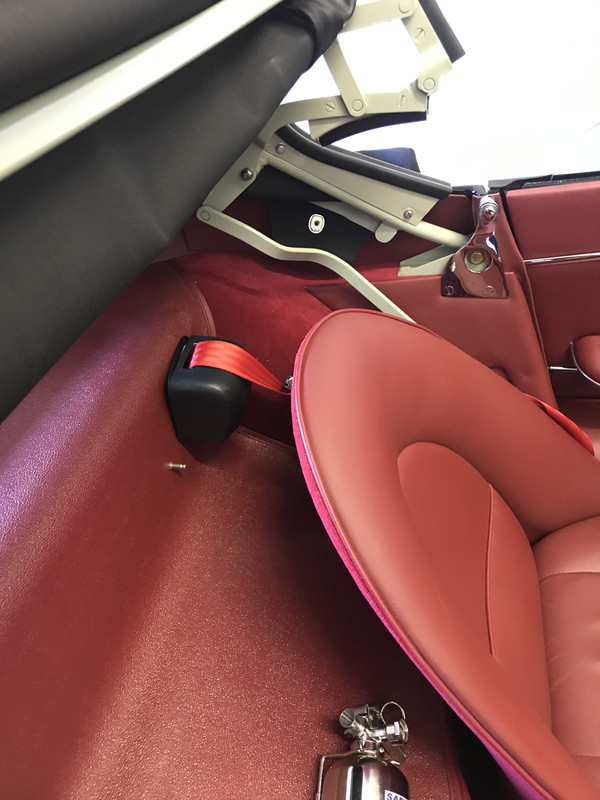

The OP is referring to an OTS. Best place to mount the reels is in the boot, cut a slot for the webbing to come through via a chrome escutcheon. Tidies it up and doesn't foul the hood when folded down.
