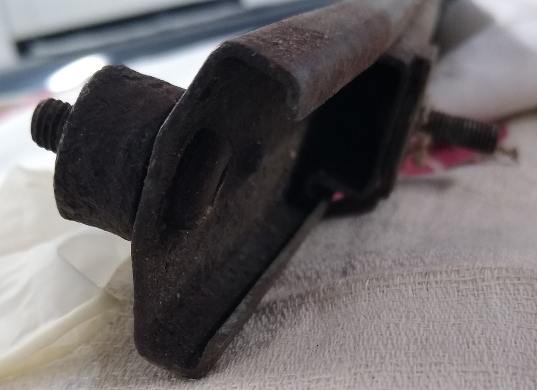

#3 Re: BD18117/4 seat slide bolts length
Hi Tadek
See attached photograph of one of my seat runners which appears to have been torn out of a rusty floor prior to restoration.
The screw is rusted solid to the spacer although it appears to be intact. It is a 3/4" long 1/4" UNF slotted pan head set screw.
I think the rail has seen better days.
#4 Re: BD18117/4 seat slide bolts length
Many thanks Stuart,
So again, to confirm it's a pan head slot screw ¼” UNF thread, not pointed.
Harold Lang e-mailed me earlier that he measured it to 25/32", which is just 1/32" longer.
The spacer that you have there on the photo is 3/8", am I correct?
Tadek
Tadek

#5 Re: BD18117/4 seat slide bolts length
Hi Tadek
Yes, the dimensions for the screw are correct as far as I can measure, no point on the end. I have no reason to assume the screw is a replacement but I suppose it is possible.
The spacer is indeed 3/8" thick and has an outside diameter of 3/4".
#6 Re: BD18117/4 seat slide bolts length
Yes, So:
Spacer: 12/32"
seat slide: 3/32"
Leaves 5/16" for the floor thread.
