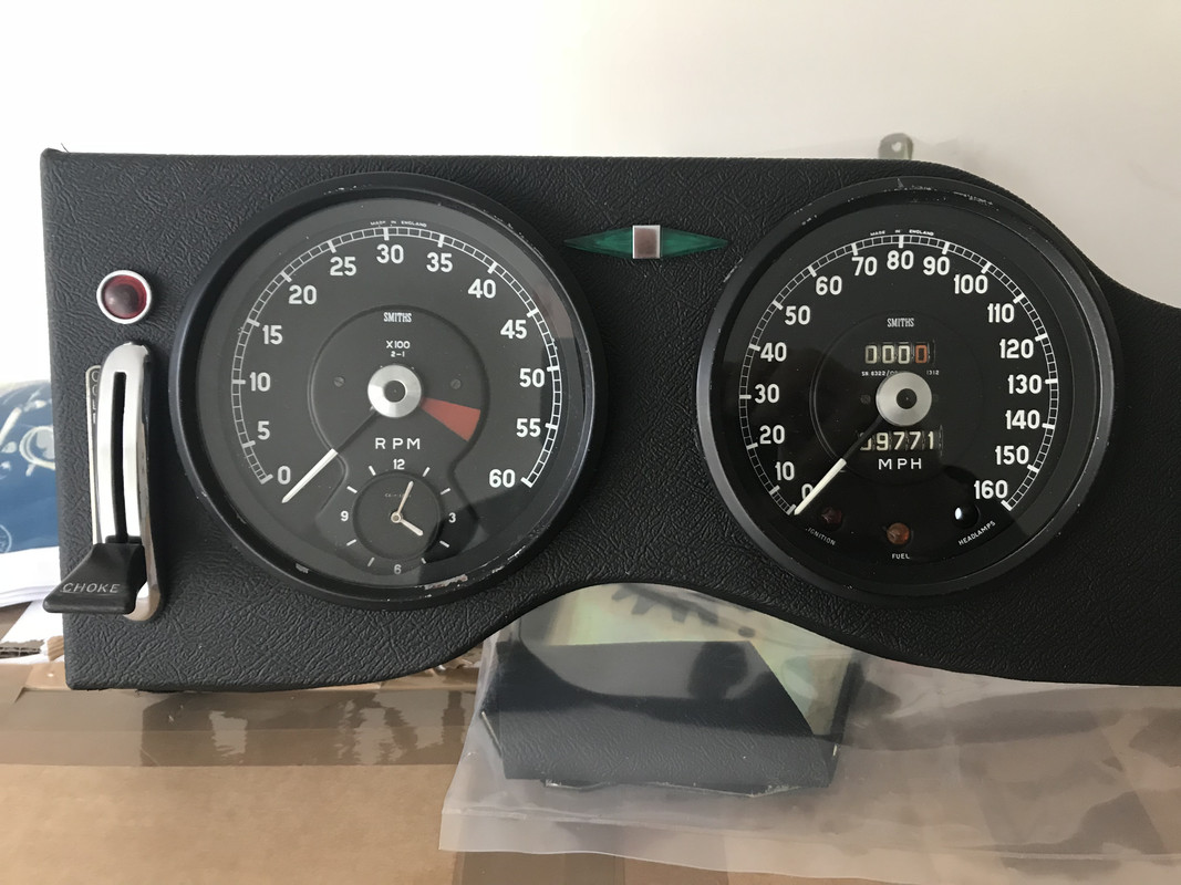

Hi all, the black rims on the instruments of my S1 4.2 are in poor shape, with bubbling paint and pitting. The instruments themselves are all in good shape. Does anyone know if it possible to purchase new rims? I have looked on line but could not locate anything. Many thanks.

Post by rswaffie » Sat Jun 19, 2021 5:56 am
These guys:
https://www.autoelectricalspares.co.uk/ ... ion=search
And search for bezel or bezels.

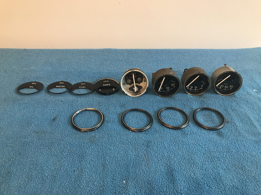

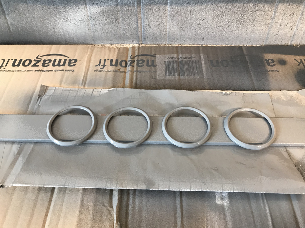

I sanded mine down, used a primer/filler spray and repainted in black. Are yours too far gone?

Post by abowie » Sat Jun 19, 2021 6:32 am
this is my usual procedure on restos. Works very well.

#4 Re: Instrument rims
Post by cactusman » Sat Jun 19, 2021 7:47 am
They are usually relatively easy.to remove. You may need to prise the tabs ever so slightly....no need to bend straight....then the bezel will twist and can be removed when the tabs line up with slots in the flange...just don't let the glass drop out!

Post by 265bhp » Sat Jun 19, 2021 7:08 pm
These guys:
+1 for that….don’t expect anything retro to fit…..then you won’t be disappointed….your bezels are worth keeping….sand/etch prime and top coat….

Post by Robbiee » Tue Jun 22, 2021 3:30 pm
I agree
I used a can spray of satin black …lovely finish

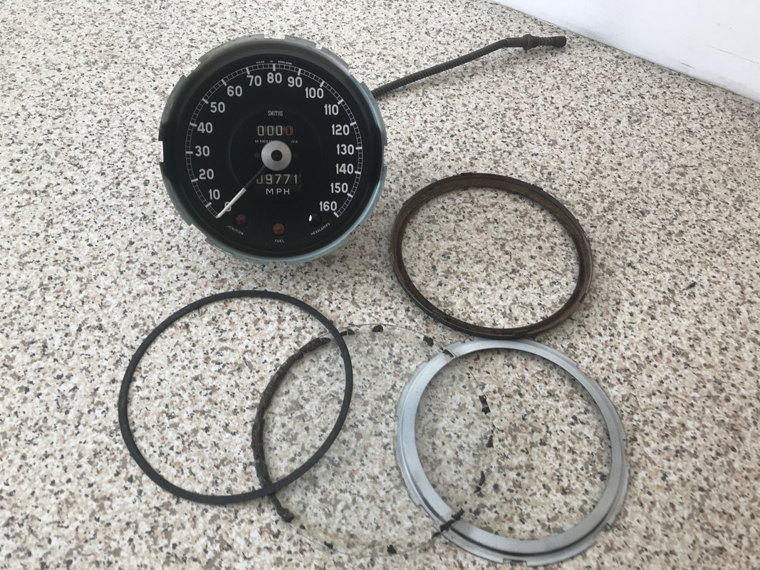

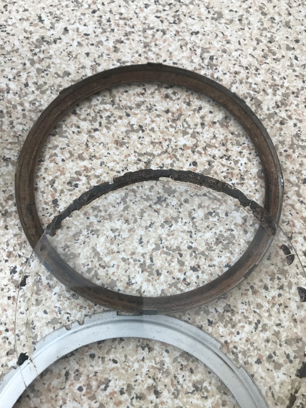

BTW should there be a rubber seal under the rim between it and the glass? Mine had something crumbly and disintegrated in it that needed removing
Also should there be a rubber ring between the lip of the actual instrument and the dashboard??
Robbie

Post by eddiecross » Wed Jun 23, 2021 6:58 pm
+1 for sanding, priming and painting the rims. Done it on 2 cars now.
Glass (just in case) and rubber seals from e-bay and only a few quid.
I bought a make up face powder brush to lightly brush the dust off the faces.
Eddie
