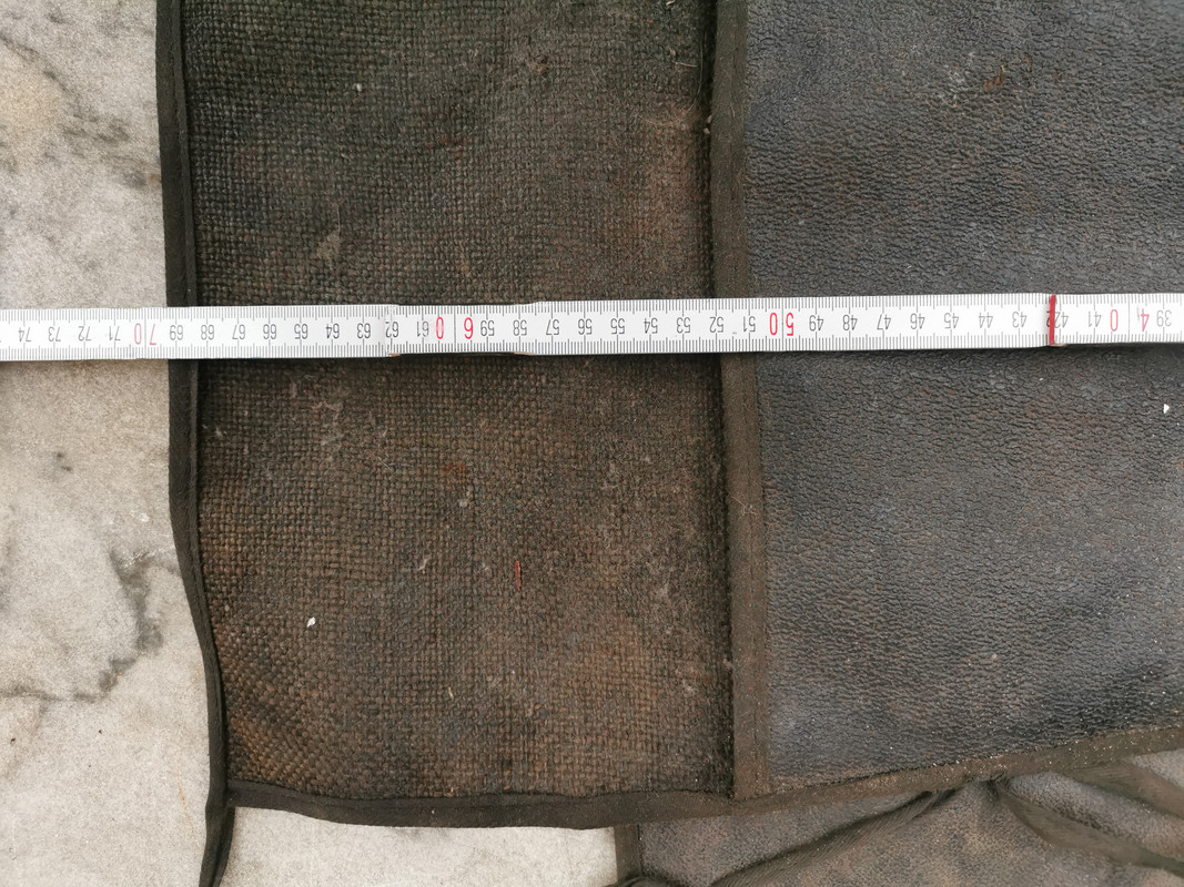

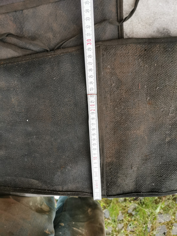

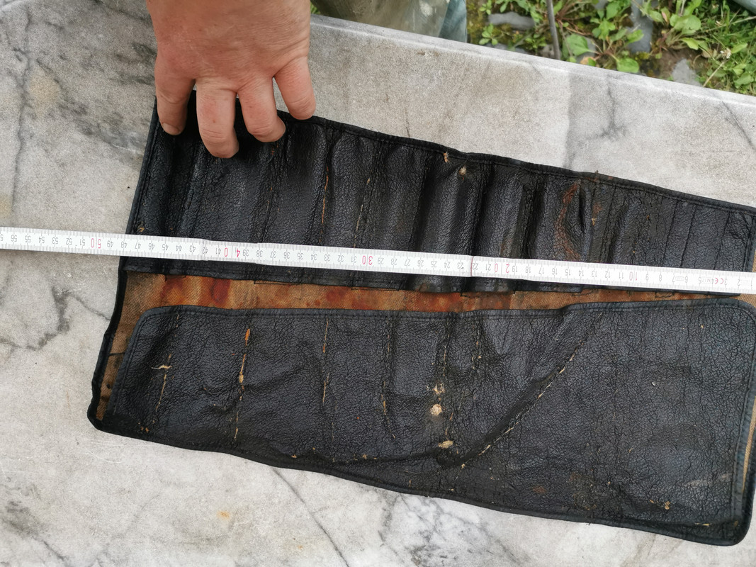

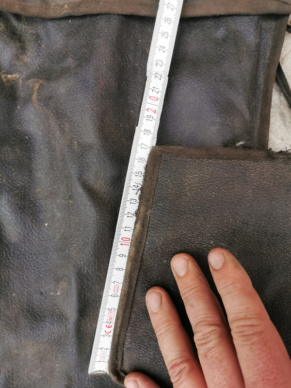

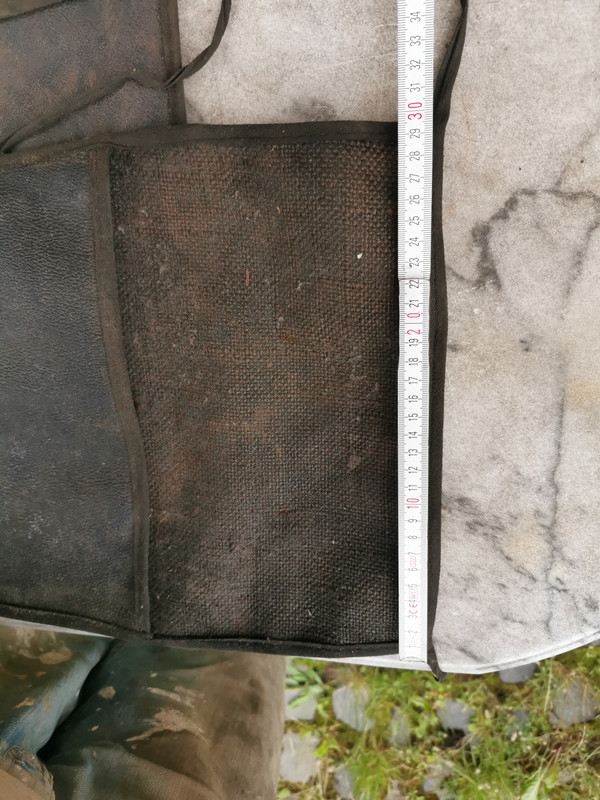

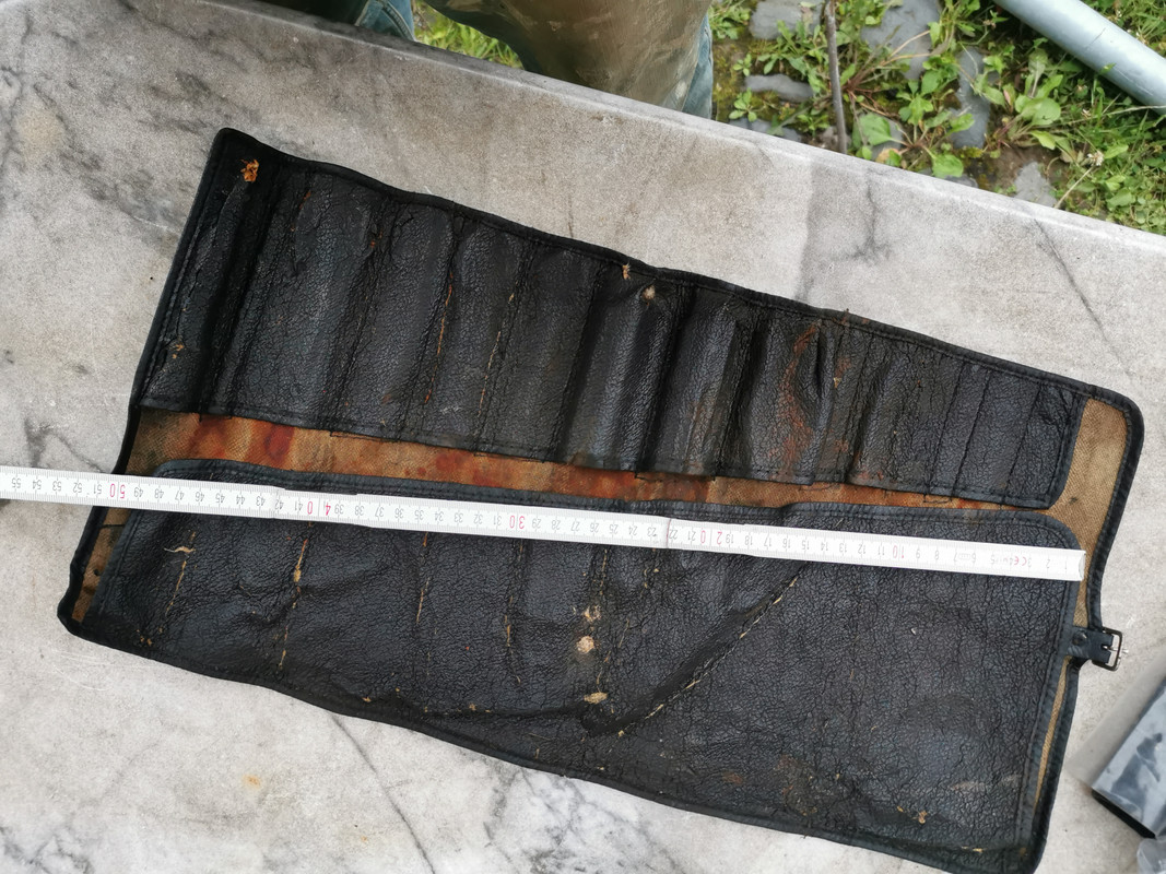

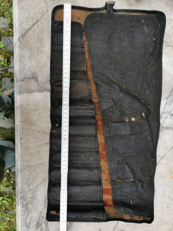

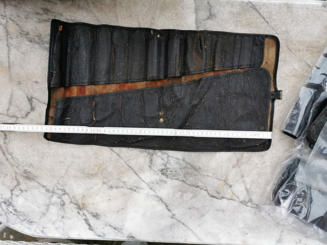

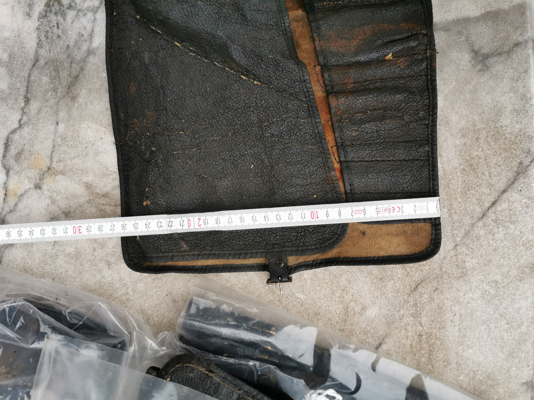

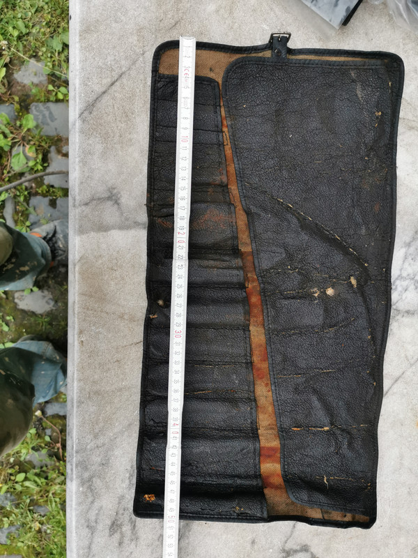

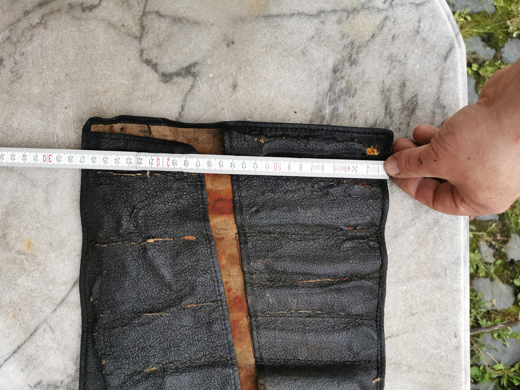

Here you go...
Hope the pics help?

Worth noting that Great Britain used imperial measurements during the time of E-Type production and as you will see from Bud's measurements they are nice whole number of inches or simple fractions to make production easy. If you are going to use the measurements provided in the photos you should convert the metric to inches and, again, round up or down to the nearest whole inch or simple fraction. If you are in metricville convert the inches to cm and do not round up or down. This applies to pretty much everything on the E-Type!

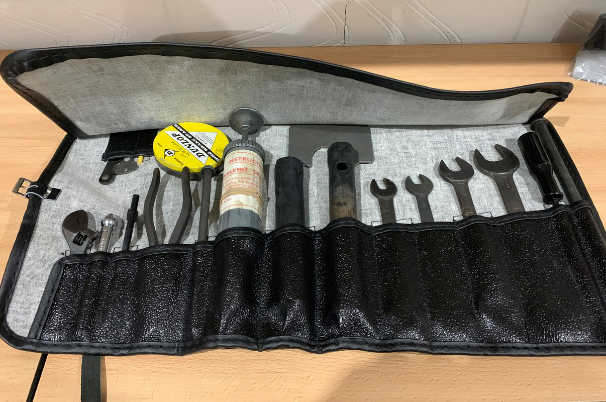

We had a new S1 tool roll made up as part of our car's re-trim. The Trim shop replicated this from our original tool roll (which was in poor condition). It is a complex job. For the tools to fit properly, there are many measurements to be taken given the compartments are different sizes plus the small pouch at the top left hand corner for the feeler gauge etc.
