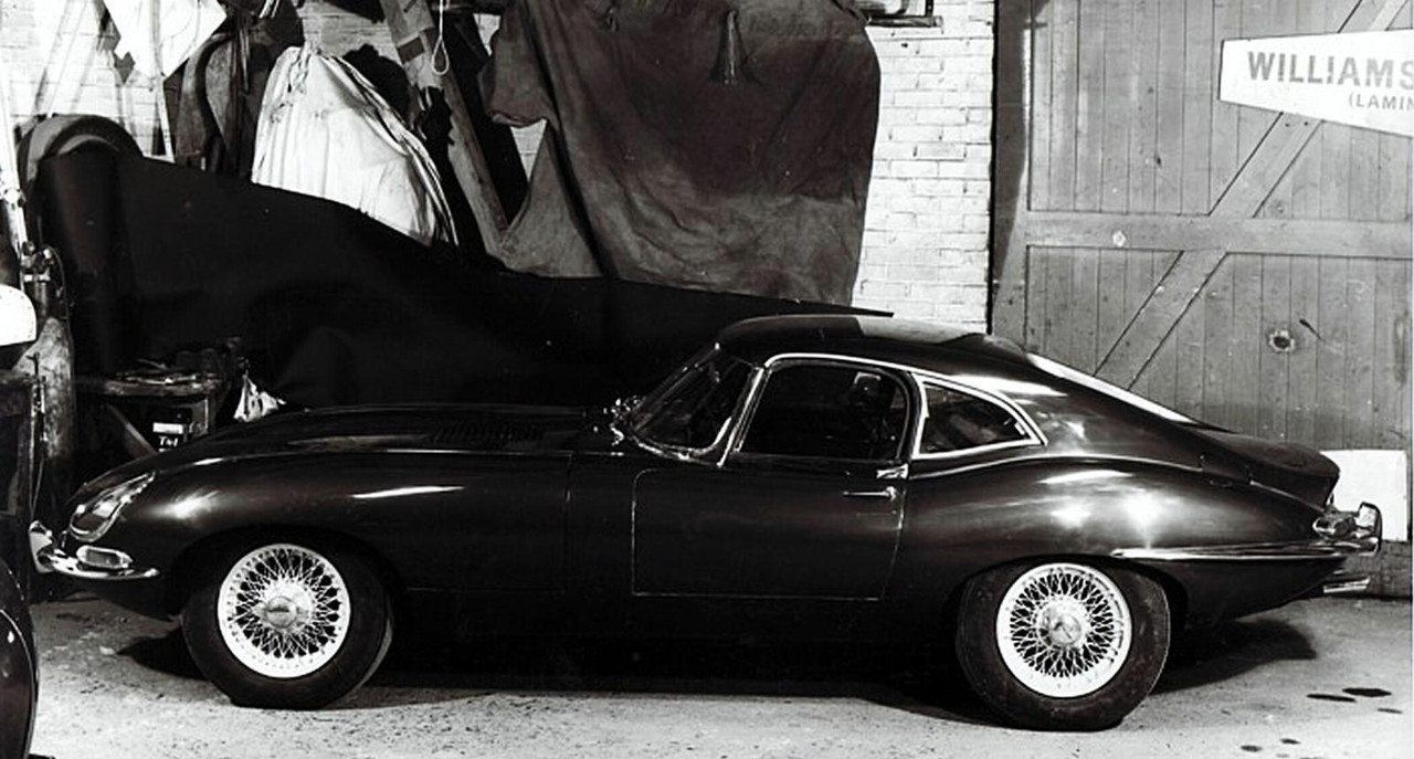

Sitting ruminating at my computer the other day, the rain pouring down outside, I got to thinking whether a run of these would sell if available.
Ashley made one as well but I have never seen either in the flesh. But I would buy one like a shot if I found one.
