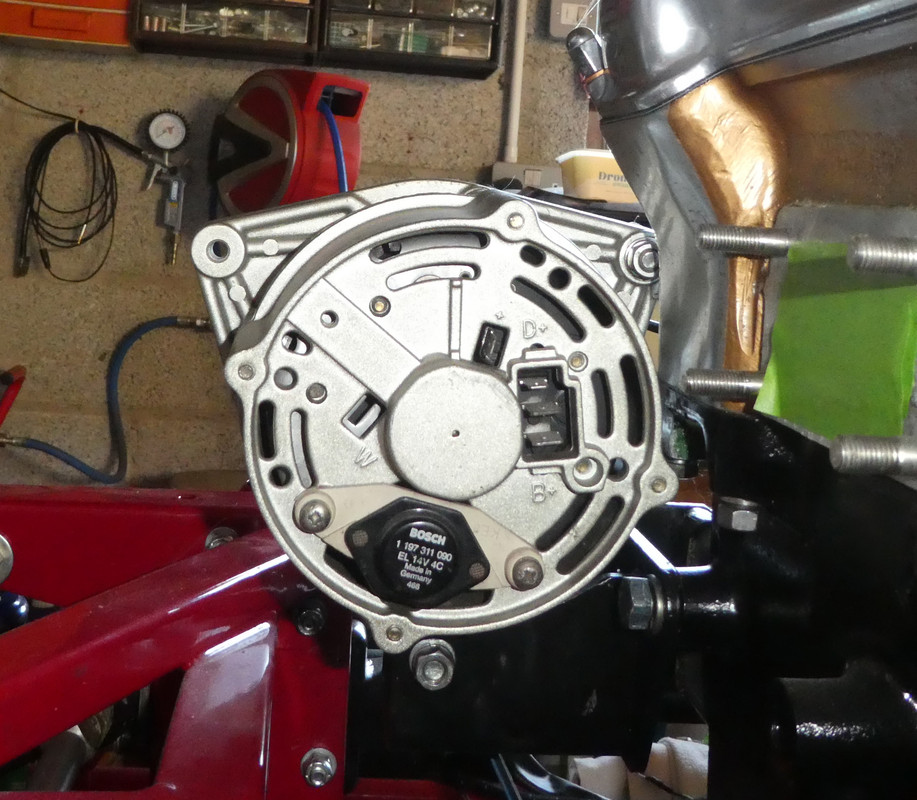

Post by gmunro » Wed Aug 10, 2022 12:36 pm
Hi David and many thanks for replying.
I have posted a picture of my alternator showing the connections available. Can you assist further in how I should connect this up and which wires go where?
Also, I will fit a Battery Voltage gauge instead of the Ammeter. Am I right in saying that all I need to do regards the Ammeter wires is just connect them together/
I look forward to your valuable comments.

Posts: 1198
#7 Re: Alternator Wiring
Post by DWW » Wed Aug 10, 2022 1:09 pm
Hi, I can’t help you with the alternator wiring as mine was done buy a specialist. I did the voltmeter conversion and yes you disconnect the wires from the ammeter and connect them safely together taking care to properly insulate that junction. Then just connect the voltmeter to a switched 12V supply and a ground. You can either use a Smiths or Lucas one, I used a Smiths using the glass and bezel from the original ammeter. Hope this helps.

Posts: 9130
#9 Re: Alternator Wiring
Post by mgcjag » Wed Aug 10, 2022 3:47 pm
Plenty of info here for a bosch conversion....Steve https://www.coolcatcorp.com/faqs/LucasBosch.html
