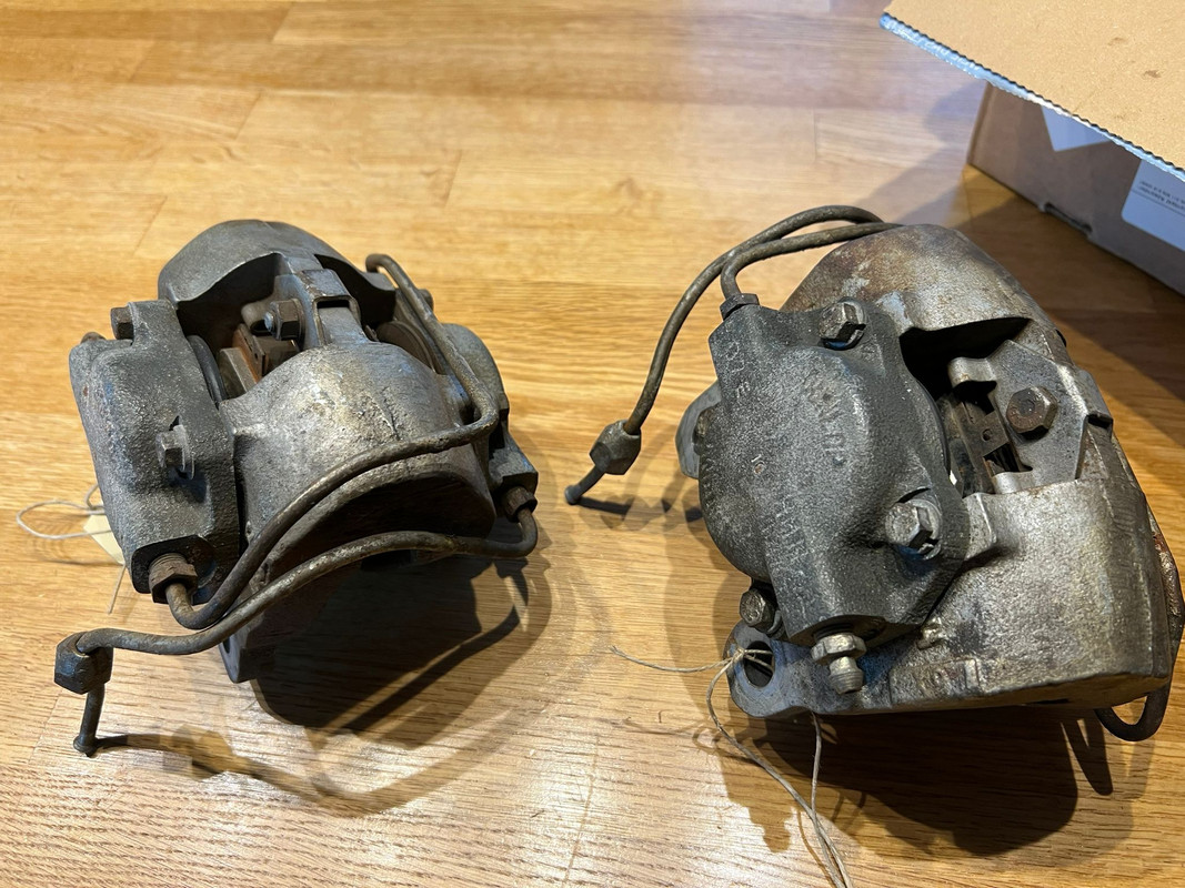

I have just acquired a set of S1 front calipers and pistons from a fellow member. My 1965 ots came with cooperkraft front calipers. I am considering going back to stock and would appreciate your experiences.
I have just finished reconditioning the rears with new discs, girling pads and seal kit, as well as the handbrake.
I am keen to achieve good front rear proportioning to make the most of the braking performance. I drive fast on the road but no track time for this car planned.
I would appreciate your experience or redirection to previous threads
Ps what color are the pistons and Calipers originally?
