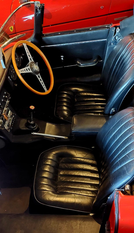

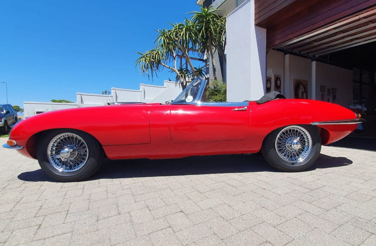

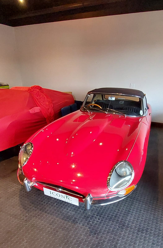

i went to view the car yesterday and was able to snap a few pictures

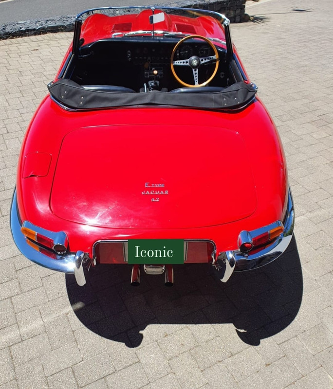

the following pics are to show the car off. below these will be pics of problem areas i have identified.

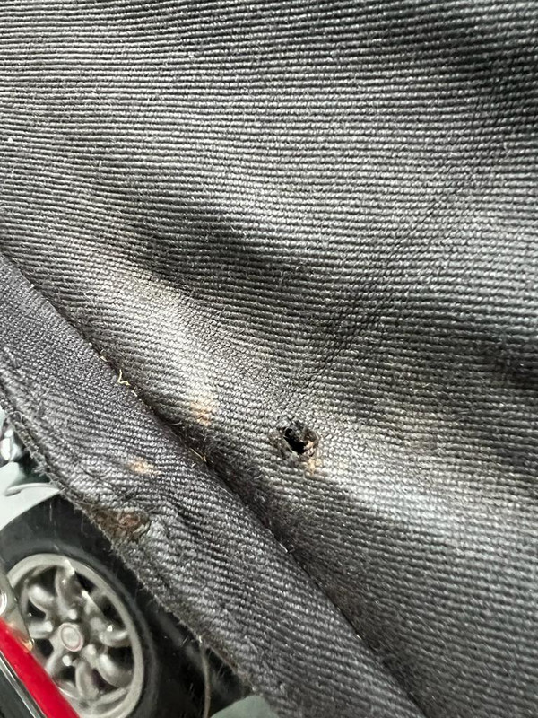

Small hole in the soft top - not to worried about this

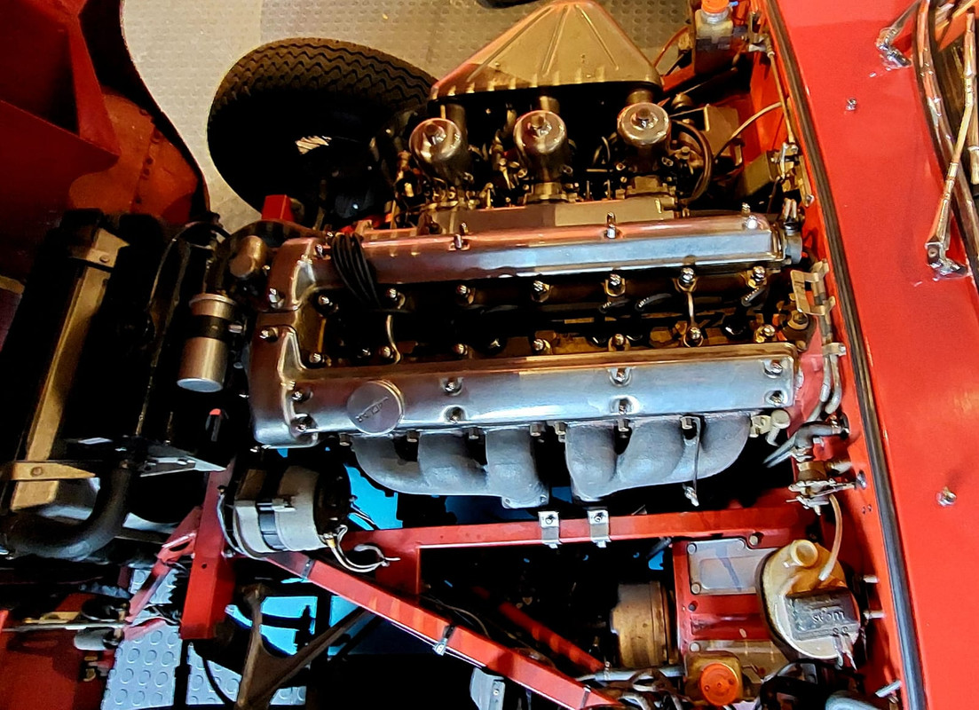

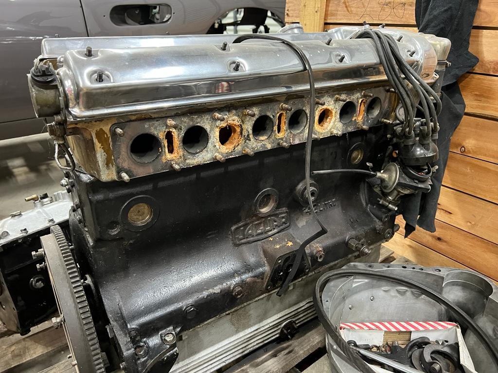

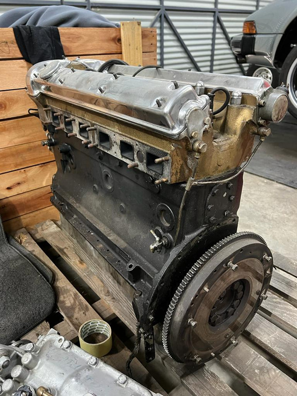

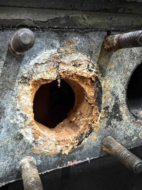

The next few pics are of the engine. gaskets will all be replaced. what i am worried about is the massive build up of rust inside the engine. take a look at the lower pictures. not sure if this is a deal breaker or not? but i am really worried that the holes are no longer uniform - ie there is significant rusting

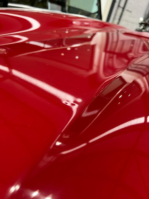

Small bump on the bonnet

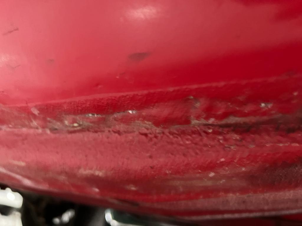

Ok the next few are of the passenger side of the car. below the battery box is a lot of rust issues.
you can also clearly see 2 lines downward and across - i expect this might be from a previous fix? there is also plenty rust issues under the battery area.

Hi...all depends on price and what you want.....the car definatly looks like a restoration project....as it is its not even drivable.........its basic classic car buying...take someone with you who can inspect any potential purchase.....in your last photo the engine frame looks rusty...these frames cannot be welded or repaired.....if damaged or rusted they need replaceing.... .Steve

The body rust at the frame is likely just the tip of the iceberg.Looks like it and other areas were painted over rust “repair” so rust was allowed to continue for a cosmetic repair. Better check everywhere with your own body guy.
The head is not particularly attractive either. You would want to clean that off to see the condition of the aluminum and concern goes to the head bottom surface to the block. Your likely looking at head repair for aluminum corrosion with a head rebuild. Check the oil if not drained for any coolant in it.

Waterways are typical, at least they look clear, but chemical cleaning will to the job.
