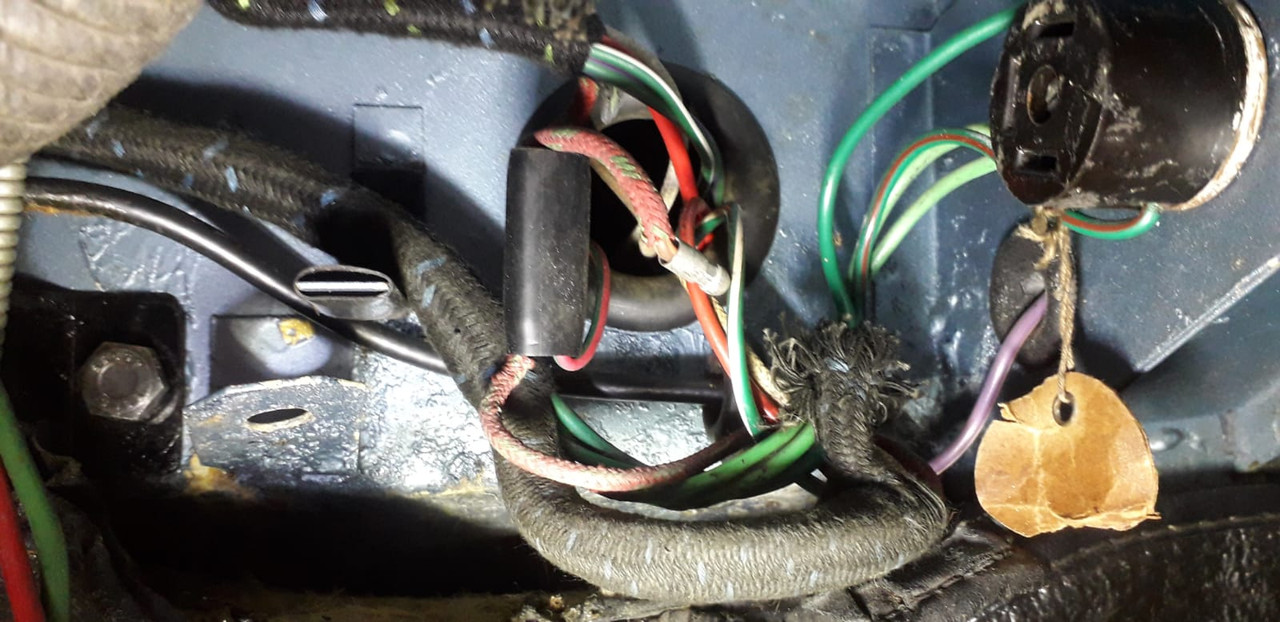

Hope this has worked!! Having a great problem posting an image.
This should be a photo of the wiring for the brake fluid warning light (from the handbrake and the 2 brake fluid reservoirs) hiding under the right hand dash above and to the right of the steering column.
You should be able to see the 'offending' wire that has somehow become detached from the 4-wire ripault connector.
Cheers,

Hi Richard
I know it's an older thread but I hope you or another may remember if this connector had 4 wires to it. ie: warning light RG, handbrake, and both RG from each brake fluid bottle. My older photos show 3 but there are 4 wires ending here from above components on the new harness'. All wiring diagrams I have seen do not have a connector shown joining both fluid reservoirs. Hope you can help
regards Peter
regards Peter

Hi Peter,
Although I can’t remember, I’m sure there would have been 4 connectors, one is the ‘feed’ and the other three are one for the handbrake and 2 for the individual brake fluid reservoirs.
Hope that helps.
Hope that helps.

#13 Re: Brake fluid warning light wiring
Interesting pic, did you remove your flasher unit for the picture or don't you have one?

Hi Randall,
Yes I did take the flasher unit out for the picture and to make sure I didn’t damage it when working on the wiring close by.
Obviously put it back afterwards!!

Hi Richard
Thanks so much for the response. I intend to connect the four in both ends of a double connector as your image. Your photo has been a great help though I notice that the connections are at the top of the bulkhead near the large grommet. Mine were just accessible below the facia and probably will end up lost in the bulkhead as your original post. Thanks again.

Hi Peter,
Glad to be of help.
It was a devil of a job trying to find the connector and gave up several times but a good friend said it’s not like me to give up so on the umpteenth search, I found it - it was (and is now) tucked in the inner bullhead just through where you see the rubber grommet lined aperture.

And there on the photo is the Lucas cable label :-)
I think there should be one for every section of wiring.
