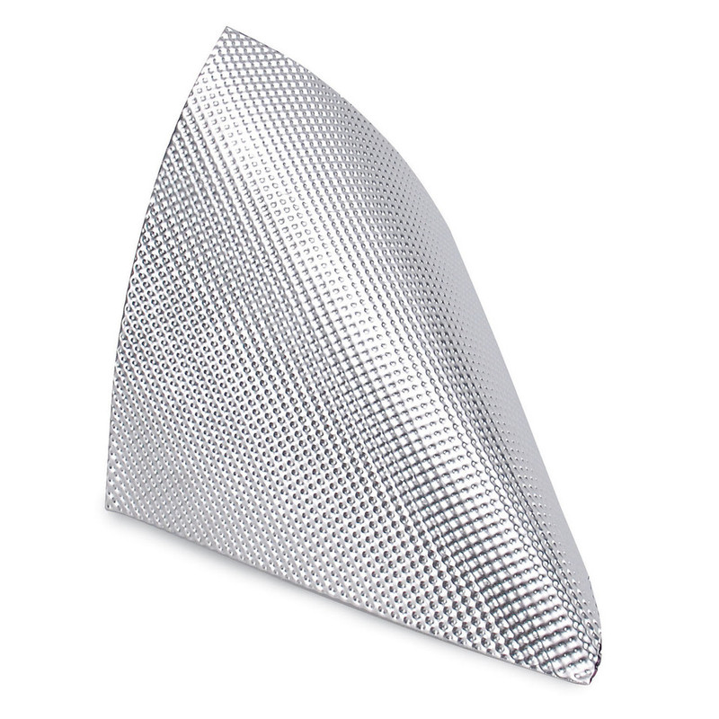

Under the tunnel, DEI reflective aluminium or similar is perfect:
https://www.designengineering.com/floor ... i-21-x-24/
