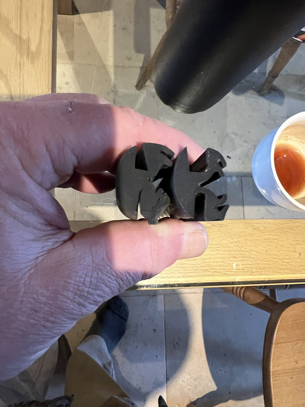

ImageOk so I was lucky and found a section of my original windscreen rubber. There is considerable difference between the original and replacement. Not least that the channel for the body location is not the same and when the new rubber is placed on the body it has the effect of thickening the rubber overall. It’s no wonder the chromes won’t fit. Usual problem of reverse engineering a product and not doing it to engineering drawings. So the question is are there any other suppliers of windscreen rubbers who have got it more exact ? I had heard that some restorers chose to fit FHC rubbers and cut them down. Perhaps that because they are accurate in the pattern ? Original on the right

tim wood
Posts: 1347
Location: Leighton Buzzard UK
#10 Re: Roadster windscreen rubbers
Post by tim wood » Fri Dec 22, 2023 11:18 am
I used a FHC rubber and cut to size. As with you I couldn’t locate one for an open car.
I fitted it ( with help from my wife and plenty of bad language - mine , not hers) I had to use a new screen which didn’t help the issue. Took about 3 hours. The side trims fit “OK” but definitely not as good as original. Held them in place with the black mastic and those blue plastic sucker things.
I sourced the rubber from Baines it seemed ok, but not a job I want to repeat.
Long and the short of it; either the screen or rubber wasn’t quite right - I guess this is similar to. Issues reported by others.
Sorry but probably not a lot of help !
Tim
