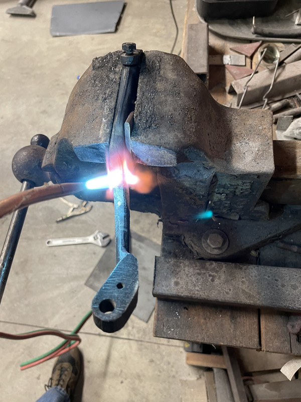

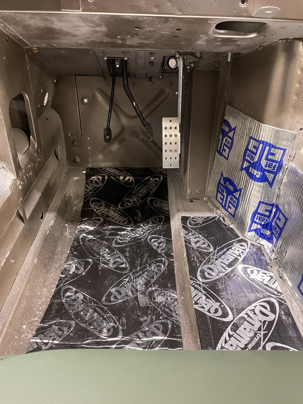

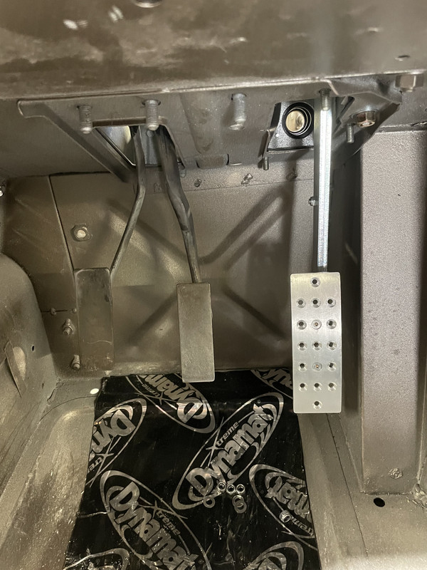

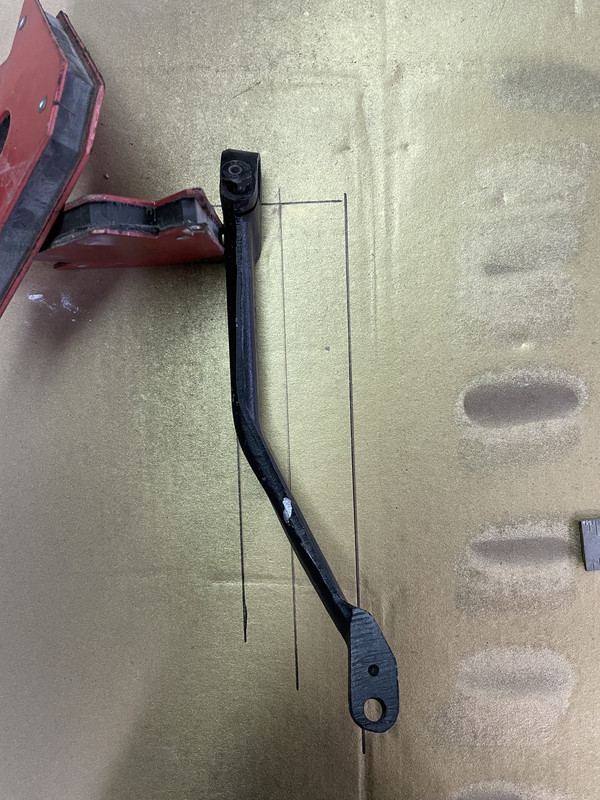

I installed the Mangoletsi on my 62 FHC. Huge improvement. I'm 6'2" and needed more legroom. I measured my TR6 pedal positions (which were also identical to my 73 BMW CSi pedals) and lit the torch. Great upgrade.

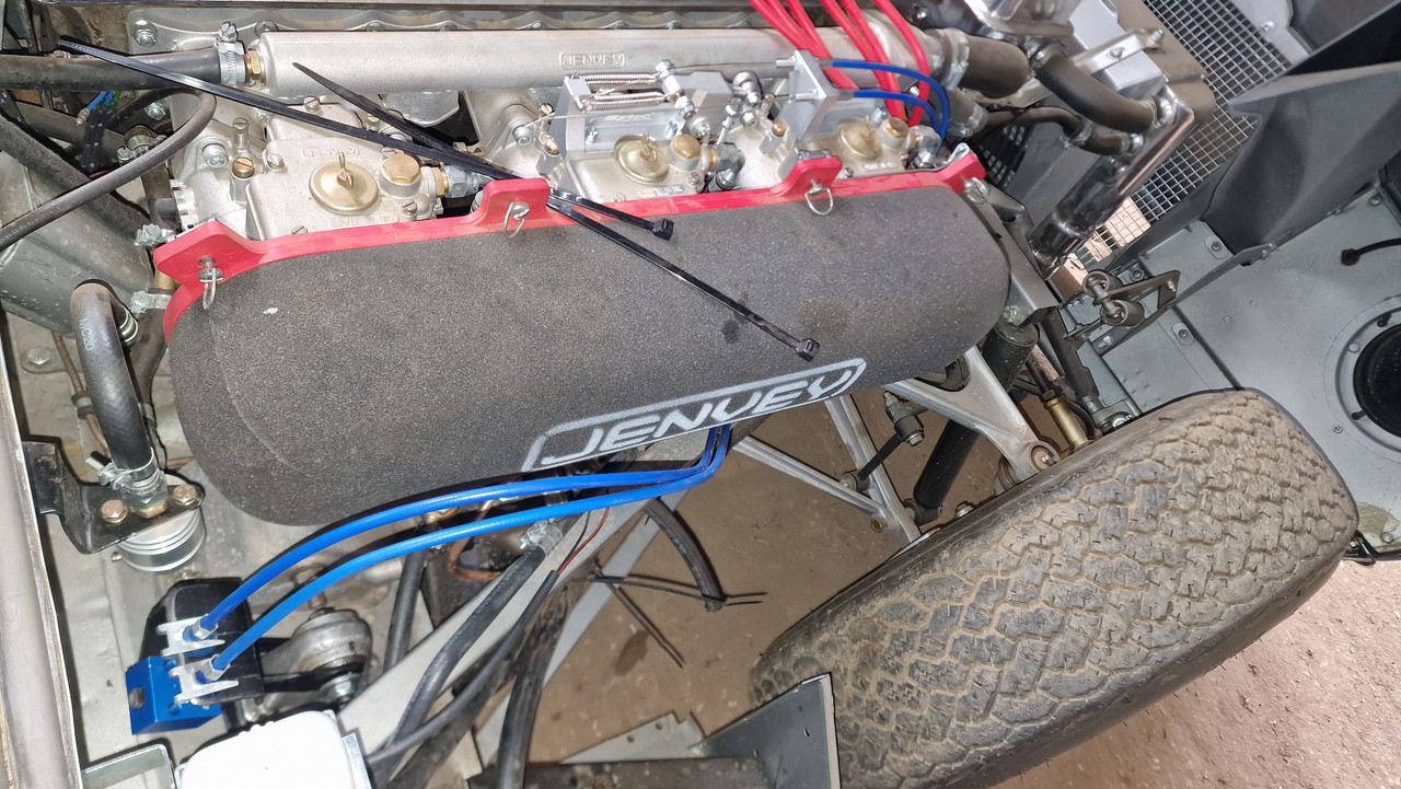

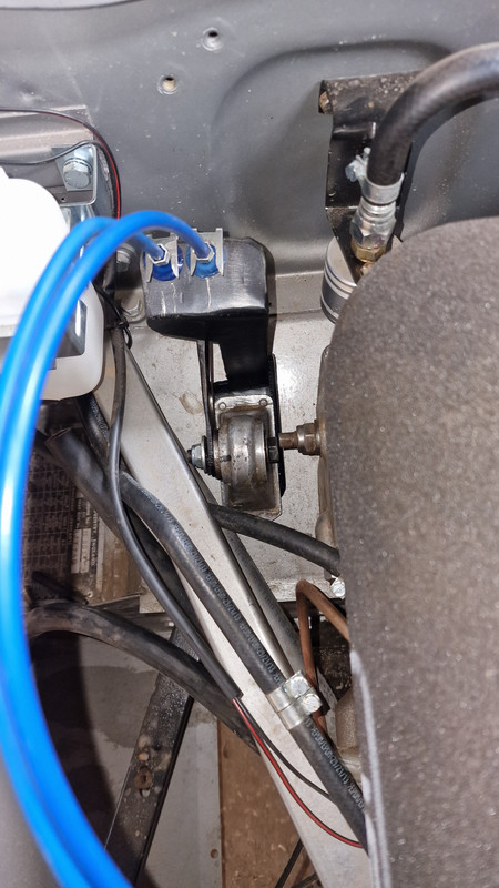

Angus has done the LHD conversion (I did the first RHD one) and being the perfectionist he is he ran the cables along the bulkhead to avoid cluttering the engine view (click to enlarge):
