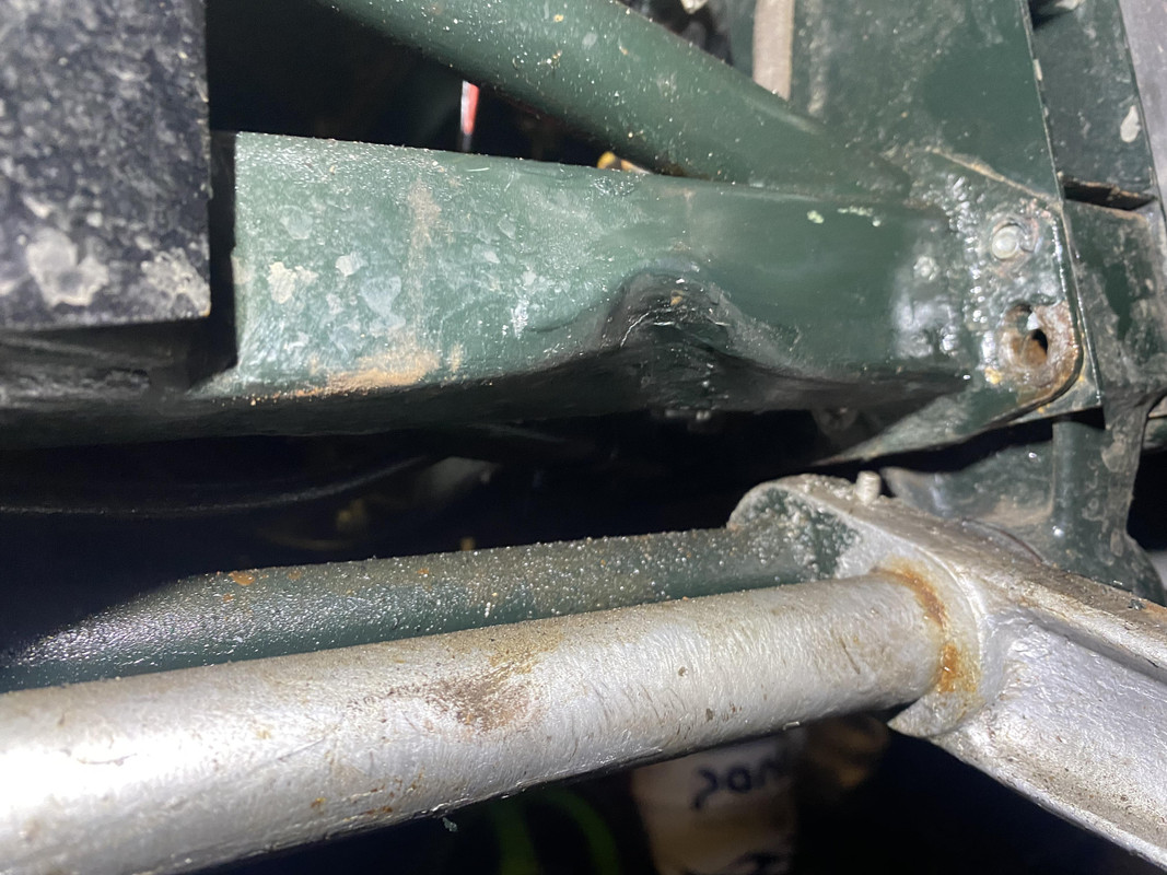

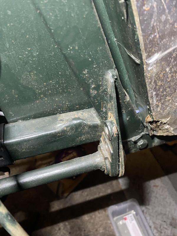

Afternoon all, who is the best place to get new engine frames from? My Series 1car has had a serious dent at some point and have had them repaired very badly so the originals need to go in the bin.

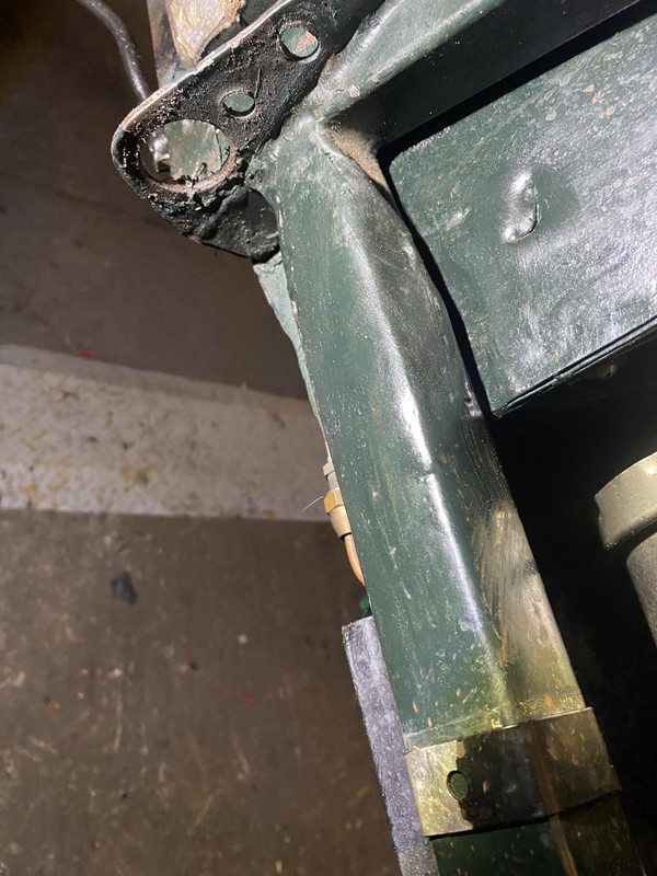

There is a very small crack forming at the weld at the back, very hard to see. Not happy at all with this.
