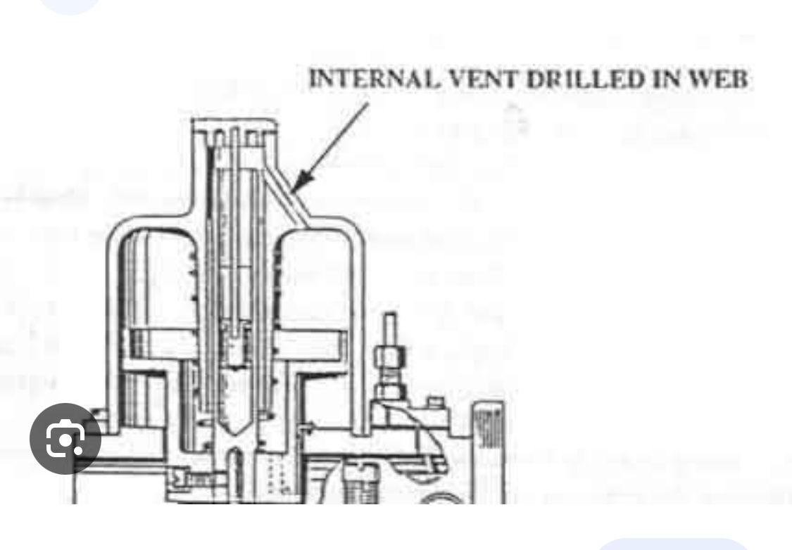

I bought and was about to install 3 new dashpot dampers for the 3 SU HD8s. I noticed that the new dampers have no vent holes, and the old ones, 2 had a hole, 1 had not. What's right?
Reading the Haynes book on SUs, they write that there should be no hole if "suction chamber is vented with an internal drilling." No picture or drawing. How do I find out if the 3 HD8s' suction chambers are internally drilled?
All 3 pistons go up and down fine when tested by hand, engine off.

#10 Re: SU experts, please chime in...

#11 Re: SU experts, please chime in...
Perfect Danny, and I've now had all three suction chambers off. They all had that drilling, which I guess is quite interesting since two of them came with dampers with a hole in, so they have had double ventilation, not good for lifting pistons...
I'm into the details now, but on carbs, the details can matter
