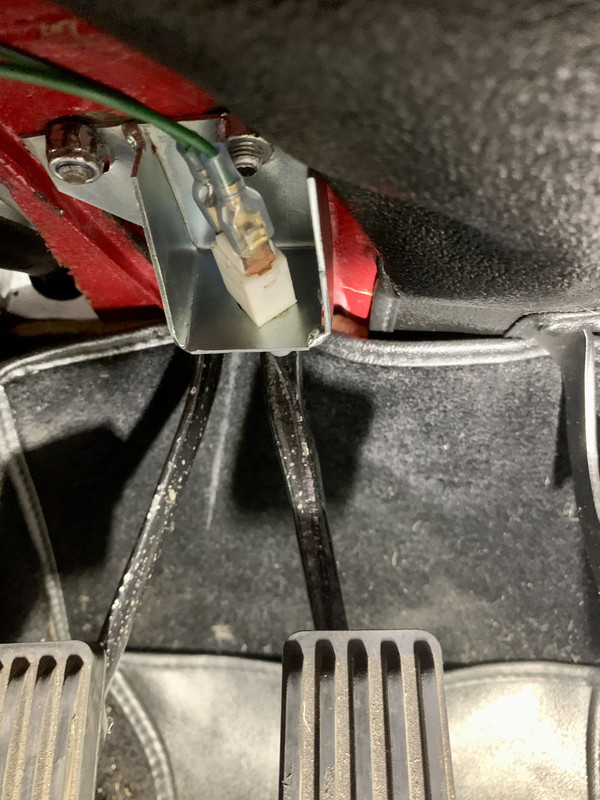

All fixed now with a mechanical brake light switch installed. Marek's led reverse/brake light works a treat. Thanks for all the help

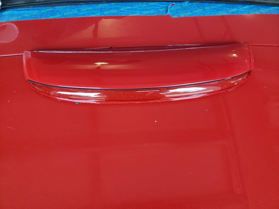

Re third brake
light for an OTS... buy the third brake light from an XK8 at an auto breaker, easy connectionto the brake light hot wire in the trunk (boot)... It also places the 3rd light up higher in line of sight. I also added a flasher unit so it flashed first then went solid..... 66 OTS
