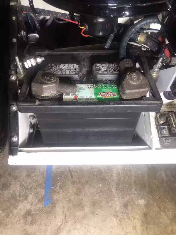

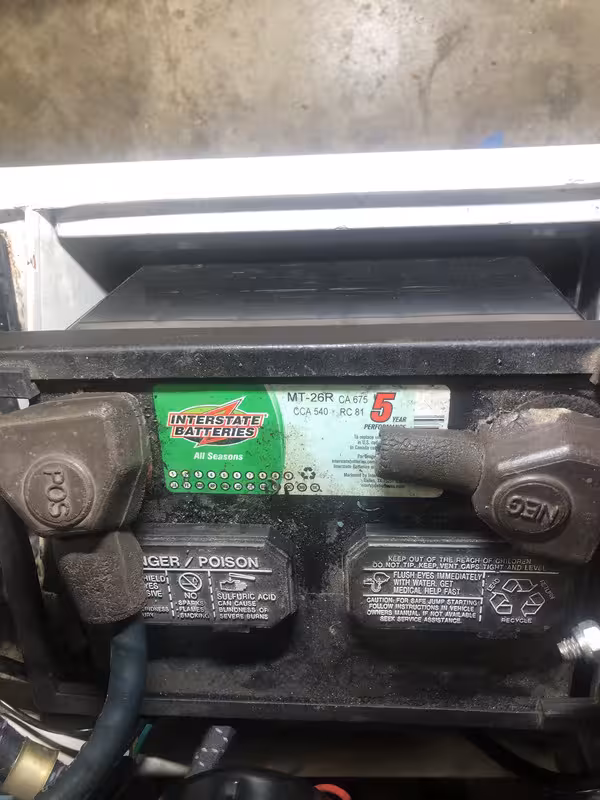

I have the "Better" grade flooded acid group 26 because it is not a huge battery and is an easy fit and has good CCA/CA.
It's an Interstate MT-26R (R is for the +/- Post position). Nice and small, fits easy, decent amps that crank the Eng with no problem, never let me down, quite long in the tooth now. I think 7-8 years old but forgot to clip the date codes.
I don't car about battery originality so I run a modern battery. Personally I'd stay away from the big hulking Group 24 or similar size you have to shoe horn in even though you can get the big amps out of em.
