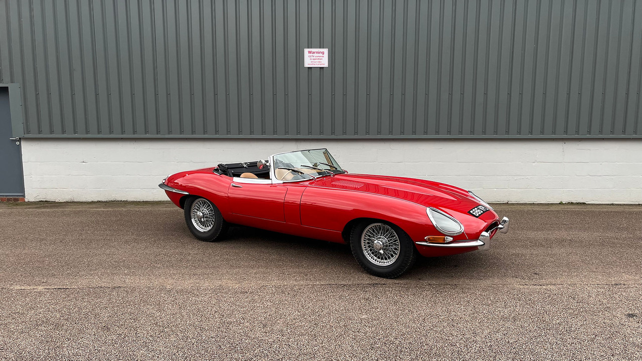

Thank you for your replies much appreciated. As I’m new to this forum I’ve got to work out what I’m posting but I have some great photos which I will post later. I’m meeting Ian Howe tomorrow which I’m looking forward to as he’s got so
[/url]
If the photo comes out this is before I started the restoration.
[/url]If the photo comes out this is before I started the restoration.
