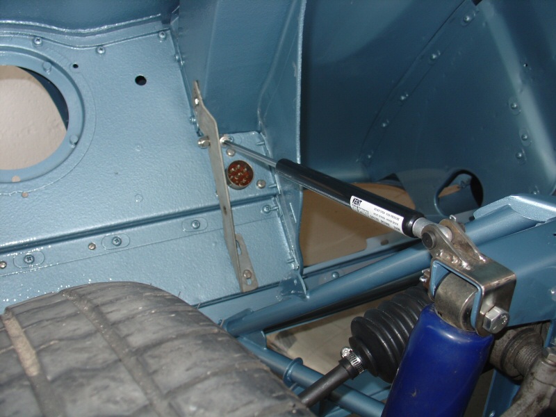

Even with new links & springs the bonnet still needed to be propped open on our steep drive. Fitting a gas strut fixed it plus the bonnet opens further or even fully by removing a single pin. Not for everyone perhaps but I feel it's one of the better mods.
Dave
