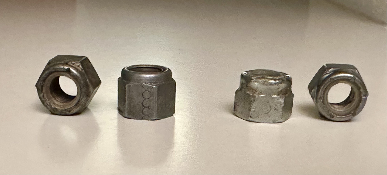

It is about 10 years ago when I took apart my 1966 OTS, which already then not been on the road for probably 40 years. In those days I did not know about Jaguar self-locking nuts with short or long skirt (and about a lot of other E-Type things). Now the “refitting-is-the-same-as-the-removal” process has finally started and despite many hours spent on this great forum, I still have some questions. Today regarding locking nuts.
Factory Fit clearly shows the difference between C8667/2(long) and C8737/2 (short).

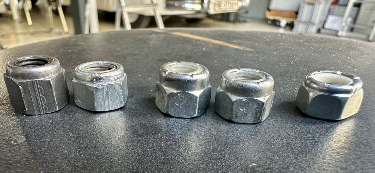

I have found 5 different types of 5/16x24 nuts:
Left in the picture: 11.1mm overall with 9.5mm skirt and 9.5mm overall and 6.9mm skirt, both with 2 indents (hope this is the right word) to hold the nylon.
Middle of picture: 10.7mm/8.5mm and 9.9mm/6.3mm with 6 indents.
Right: As supplied today.
The Part Catalogue specifies 8667/2 for the side frames to picture frame and to dash. On my car though I found the longer version of the middle pair in the picture with overall 10.7mm and skirt 8.5mm with 6 indents.
And now finally my question:
Should it really be the nut with the very long skirt (overall length 11.1mm or 7/16”, skirt ) or does the 4.2 have a different 8667/2 which is 10.7mm overall with skirt 8.5mm as I found them on my car and it seems to be the same as on the 26kmiles primrose yellow S1 4.2 in Factory Fit?
As for the C8737/2 short skirt, I am not sure which one is right. On the studs for the brake pedal box I found the 9.9mm with 6.2mm skirt and 6 indents (together with the „real“ long skirt one for the clutch and brake cylinders.

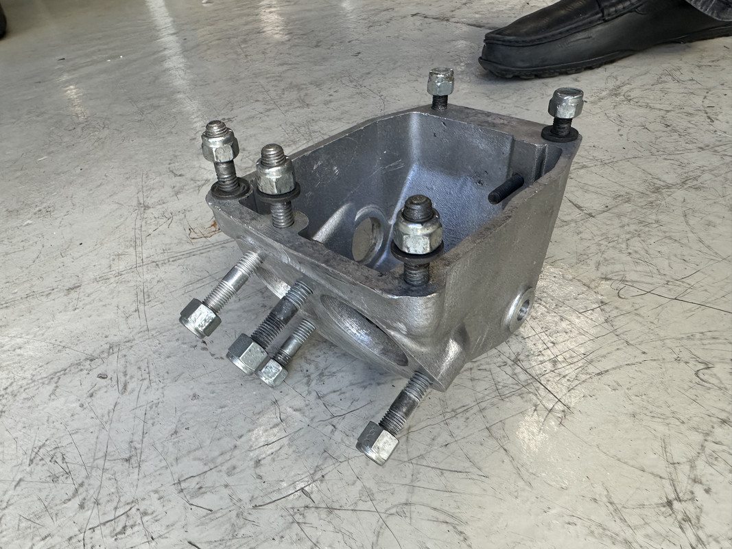

Here is a photo the my frame nuts on my feb. 67 OTS, which I believe are original. Hope this helps.
Philippe
The 2 on the left (certainly the left most one) appear to be Metal Lock nuts, hence the taller collar/different format.

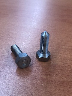

In most cases, you can find bolts that have the correct plain shank length as the original, but with a Thread Length that is profoundly excessive. When required, I set up and machine batches of bolts that have the correct Plain Shank length to the correct overall length, and while I'm at it, I machine the shallow dish in the face of the bolt's head, as shown in the picture below. They don't have the correct, original markings on the face as the originals, but at a glance, they pass as original; certainly better than Off The Shelf.
The following picture is of Door Hinge Bolts. These weren't made from existing bolts, but from scratch out of bar stock. Note the Dish Feature in the face of the head.

- The 5/16” Nyloc nuts available today all seem to be less than 9mm in height. For the way I drive my cars today, i would not have any safety concern if the product is from a reputable supplier, but It does not really look right. And the “Fahrgefühl” with the right nuts ….
- on my car, of the nyloc in places where the parts book specifies C8667/2 I only found 4 long skirt (definitely with nylon insert) on the pedal box, the rest are of the version with approx. 10.8mm height and a shorter skirt.
- together with the foto from Pilippe’s car (thanks) and other evidence, I will assume there is 2 versions: long skirt 7/16” (11.1mm) and a version (newer?j with almost the same length but with a shorter skirt.
Now I have to find enough nuts of the long version with the short skirt to cover all the 84 lockin-nuts C8667/2 I counted in the parts book (minus the 4 long skirt). I will start my search even if it might be quite some time before I will use the last ones…
