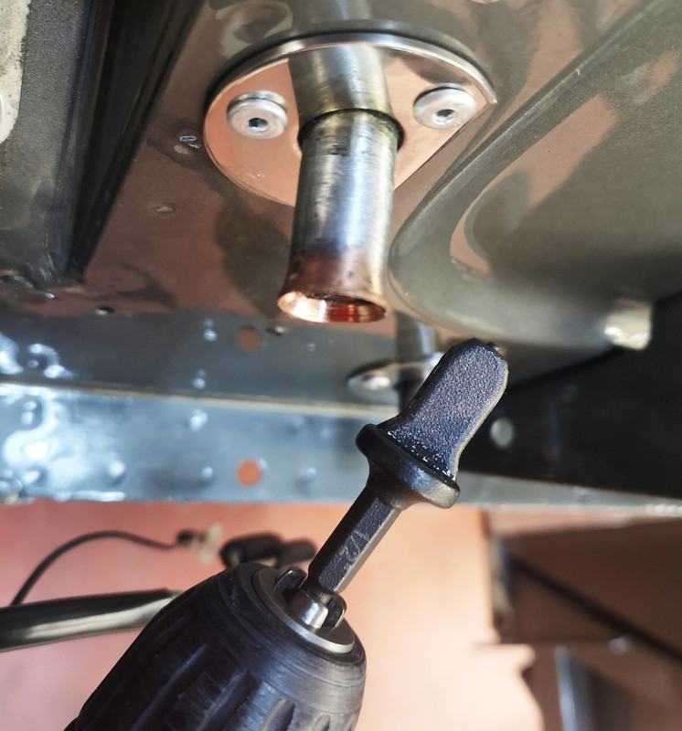

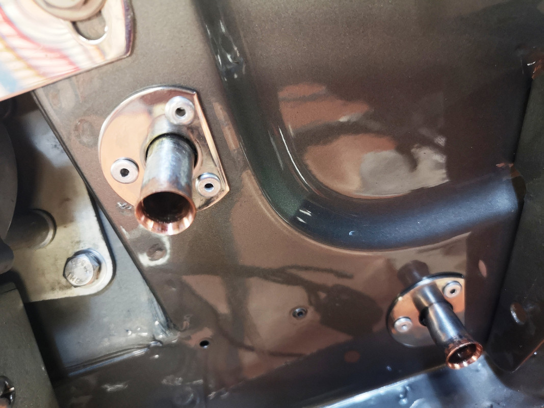

Post by rfs1957 » Mon Oct 02, 2023 5:33 pm
Ca marche !
30 seconds on each pipe stub, to get a most satisfactorily swaged end.
Pipe location feels much more positive.
