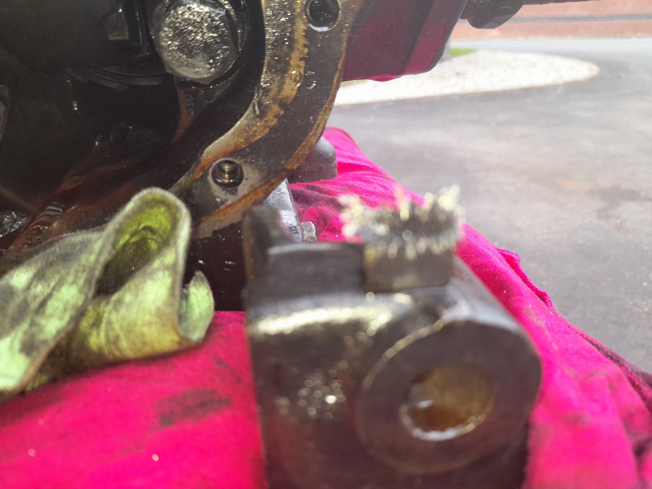

I've come to look at the diff and surprised at the amount of iron filing centred around the drain plug.
To those who are far more experienced in stripping these than me, what could you typically expect from a 60 year old differential.
The crown drive looks good although I've not checked wear pattern yet.
I've attached a photo of a magnet I used to pull it out. Probably 3 times this amount in total.
Advice would be most appreciated.
Many thanks
Al

Though your photo is unfortunately out of focus, it still appears to me that the amount of metal present on the magnet is alarmingly high. To me this suggests a full disassembly to determine which components, exactly, are the source of all this material. I would think it would be fairly apparent once everything is clean.

Many thanks for the responce. I was aiming to do a full strip down. As you say steve, the amount of debris is so great the problem should be fairly obvious.
I've done input/output bearings on this style diff for my cobra. It will be interesting to split the actual diff this time.
Alun
