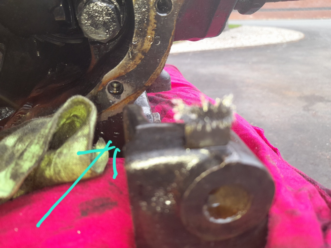

Lots of great info there from Bill.....Al have a look at your diff where iv put the arrow....stampings can sometimes identify the year of the diff....possibly you whole diff is a replacement....Steve

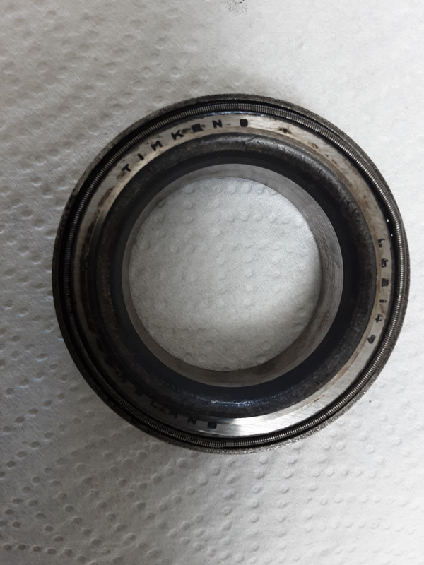

Bill, the spring I mentioned is the one around the top of the inner output bearing, photo attached.

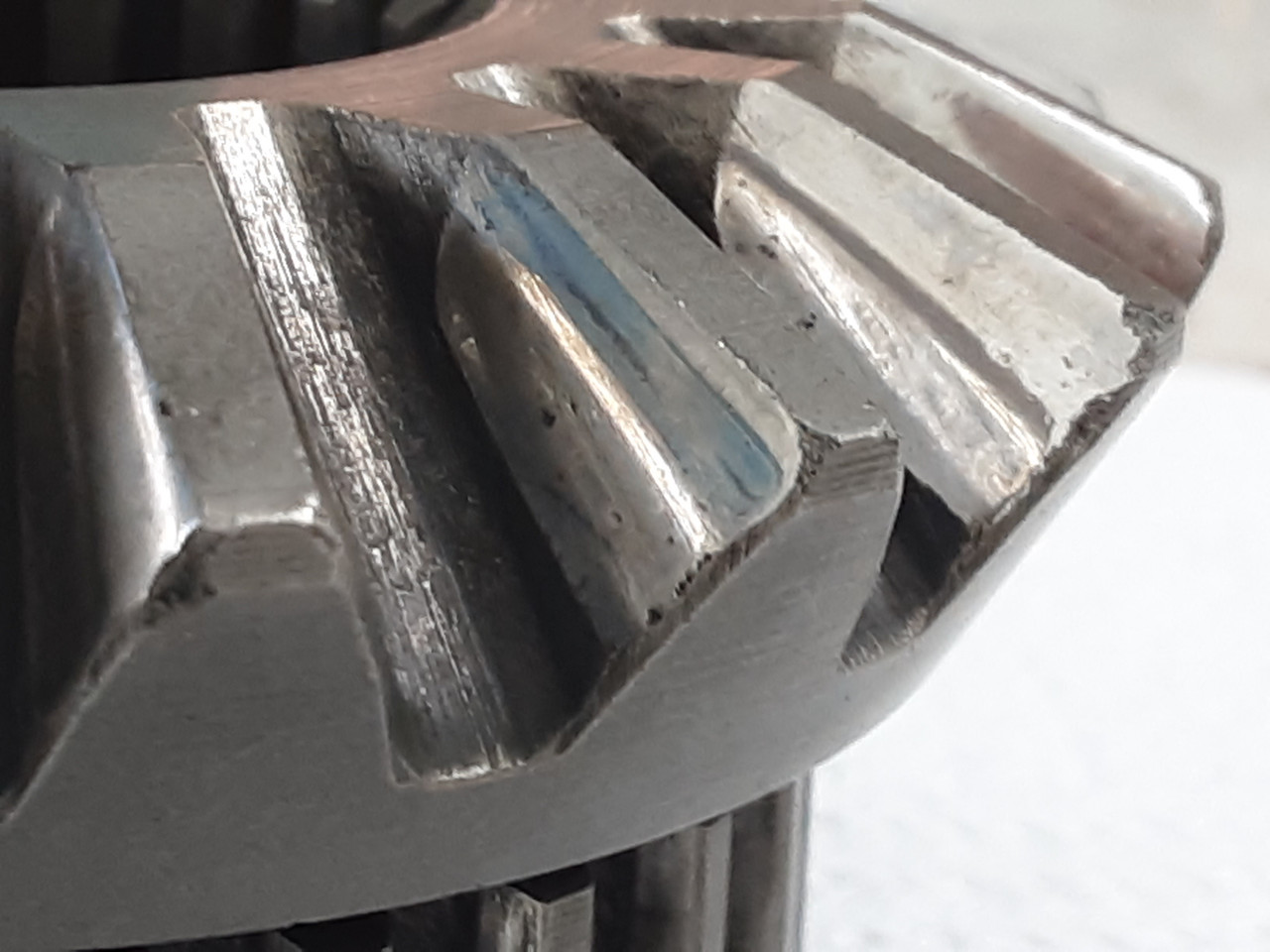

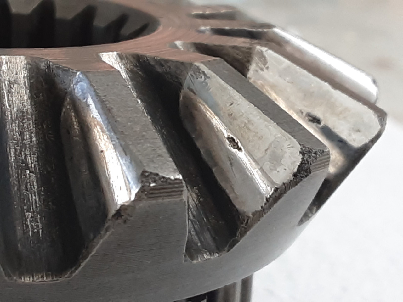

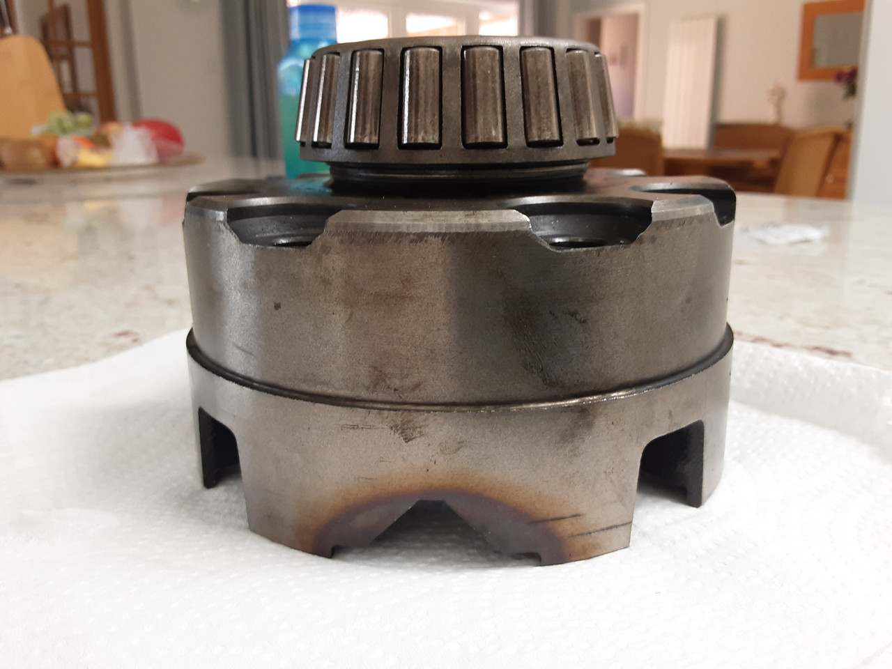

This diff has had a hard life. Traces of overheating and a gear which is showing signs of having crunched something up.
Steve, The number you refer to is 90E 83496, is that 1983?

Hi Al...90E I think is 1990 so S3 xj6..the spring is probably fron an oil seal....are you aware that diff mount brackets are specific to E types..so if this diff was just in a box of parts the mounts may also be xj6....how about the irs cage, driveshafrs, wishbones etc...do you have larger xj6 parts or E type parts....Steve

Hello Al,the spring I mentioned is the one around the top of the inner output bearing, photo attached.
That spring is not a part of a Taper Roller Bearing and is most likely as suggested by Steve.

Looking at the spring you're correct, although how that popped so neatly around that bearing is another thing!

Any views on the gear wear and the overheating - just running with low oil?
Would you trust it or change it.

Plenty of info on the mounts/dog bones if you search... here is one viewtopic.php?f=3&t=10004&hilit=Dog+bones as re diff condition the gears dont look great to me plus whatever else needs doing....I would be looking around.....are you keeping the car auto or converting to manual?.....Steve ps you could just look at fitting one of the new LSD units keeping your crown wheel and pinion and o/p shafts

For the amount of work required in refurbishing your current diff, plus the work involved to getting at the diff for a second time after you get to the point of car being derivable, I would be replacing the gear set.
