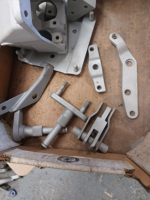

Hello the company,
Just working through the servo / pedalbox bits, Loic.....
Do you know what colours this lot should be..?
Main peddlbox
Bellows rear plate
Master cylinder linkage
Best regards
Loïc

#2 Re: Colour of servo pedal box brackets
Post by Heuer » Thu Jun 18, 2026 11:26 am
Pedal box - Dove Grey BS381C-694 (same colour used on Stone Guard frame, radiator tie bars, master cylinders bracket, brake hose support brackets)
Dunlop bellows rear plate: unpainted alloy (note PT - pressure tested - yellow stamp)
Linkage: mix of cadmium plate and semi-gloss blackpaint:
