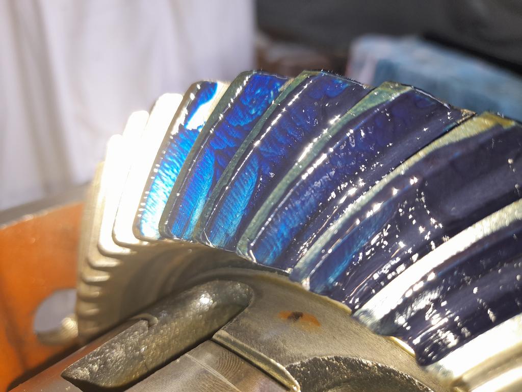

Having been laid up for the best part of 6 weeks, I'm finally getting around to finishing my diff rebuild.
Output shafts set up, no real issues
Clutch plates replaced and replacement set of gears installed
End float shims defined for diff side bearings and preload
Run out is zero
Because it's a 2.88 ratio diff, the standard pinion height of 2.265 doesn't apply so I've used the original shim under the pinion inner race of 0.030.
Backlash set to 0.008
Crown gear mesh pattern is attached. What's the view from the more experienced - OK or does the pinion height need to change

#38 Re: Differential advice
Can't really see you marks its all too greasy.....what should the pinion depth be on a 2.88 better to know and calculate shim....this from the service manual....Steve
#39 Re: Differential advice
Hello Al,
It appears that you've used Bearing Blue, which is not a good choice in this application, Because it's rather sticky, it doesn't easily display a good mark. If you were able to coat the teeth of the pinion gear teeth, and have none on the crown wheel, then it would give a better result, for blue from the pinion would be being transferred to the bare crown wheel. Of course, this is not easily possible, and having the blue applied to the crown wheel results in the blue being pushed around on the crown wheel teeth, and a not so easy to see contact area. The fact that you have way too much marking media on the crown wheel makes it even harder to clearly see the tooth contact in that picture.
What I find is a good marking media, and it leaves a very even amount of material on the contact surfaces, is the soot from a pure acetylene flame. Accordingly, if you have an Oxy Acetylene welding set, I suggest you use that. It's easy to apply a very even, thin deposit, and because its adhesion is quite fragile, it displays the contact without much effort being applied. If you don't have an Oxy set, Marking Out Blue is a better choice than Bearing Blue. It's a rapidly drying, very low viscosity Blue liquid used more in the days before CNC machines, where features that were to be machined were marked out on the work piece. It drys quickly on the surface its applied to, and because of its very low viscosity, a very thin, even coating results, which is worn away by the contact of the teeth of the two gears. Not as good as Acetylene soot, but way better than bearing blue.

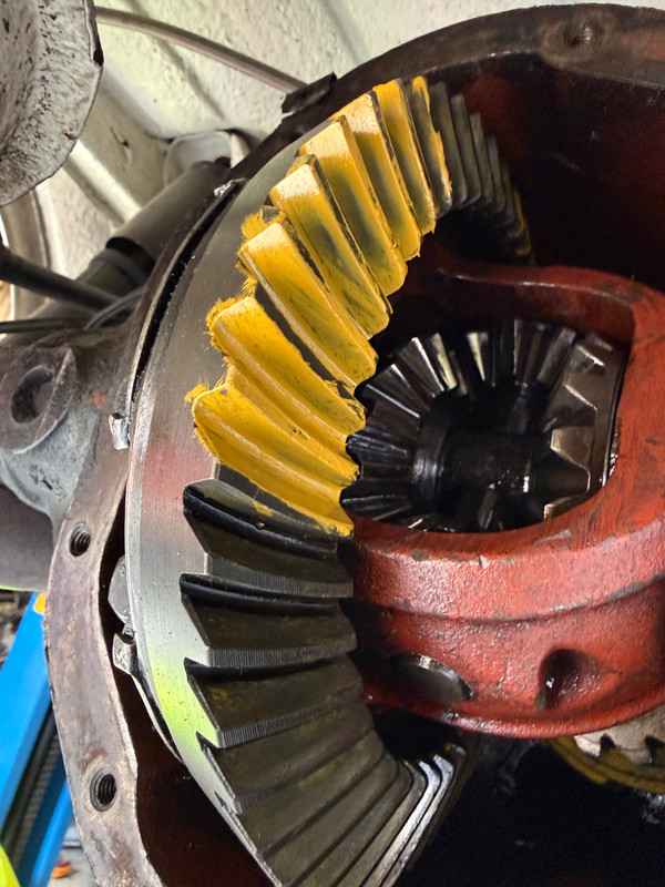

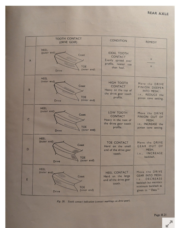

#40 Re: Differential advice
Apparently you can mix white lithium grease with powdered turmeric to make a yellow paste.
I managed to buy some yellow paste locally. It's much better than your blue.
From what I can see on your picture the tooth contact is too high and a tiny bit too much towards the toe.
This is how the 3.54 diff in my Mk2 ended up. The pinion height was exactly 2.265 so I left it alone, and I ended up with 6 thou of backlash. It sounds fine when driving.
