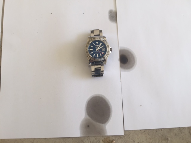

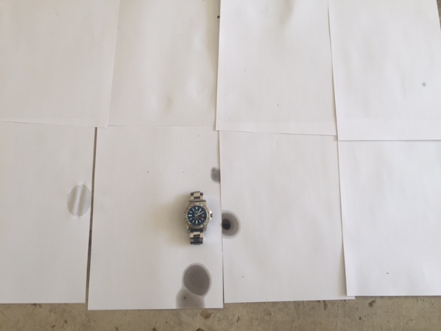

Been finding blotches of what is either oil or petrol on the garage floor. This occurs between the front wheels, about smack in the middle. Two days ago, I decided to put white sheets of paper under the car to try to catch it. After a little night drive, the next day the paper was clean, but it seemed a spot had missed the paper. So last night, I extended the area covered by bright sheets of paper. Drove her again for a little night drive last night (checking a discharging issue when idling with headlamps on - that's for another day). This morning, I took photos of the oil/petrol on the white paper.
I suppose I could see how well the stuff on the paper burns? Petrol should flare and oil not?
Oil or petrol?

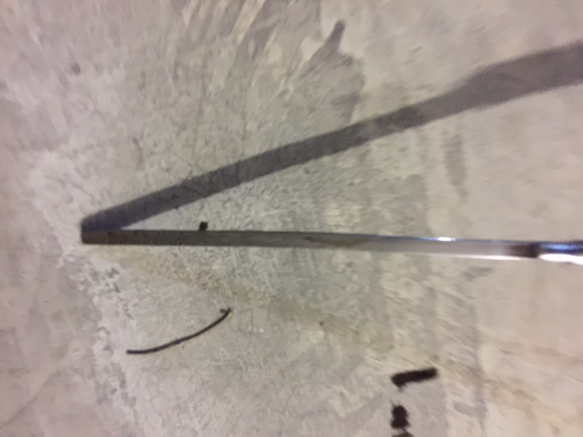

1. Have you checked the dip stick is perfectly flat? It can end up with a curve in it because the sump baffle bends it which leads to under reading of the oil level. This in turn leads to over filling which can be very hazardous to the engine. If the level reaches the crank with the engine running the oil will become aerated (constantly being slapped by the small ends) and the pump will be ineffective leading to bearing failure. I know of one person who had to have his engine rebuilt as a result! If in doubt drain the oil and refill with the recommended measured amount and look to where it comes to on the dip stick. Mark it with a small file so you know what is correct for your engine.
2. Fuel can drain from the carb overflow pipes if a float is faulty - try putting a jar or bottle directly under them after a run although bear in mind it will evaporate over night.
3. Your blobs look like oil to me and you should be able to smell it. The paper causes the oil to separate leaving the black blob in the centre. If it is fuel you should be able to smell it. If in doubt drop a bit of oil and fuel on the paper and compare to the ones you have.
4. Check the fuel filter bowl as fuel can leak if the gasket has failed or the retaining clamp is not tight.

Well, if by "flat" you mean straight, then my dipstick is anything but. It has a huge kink in the fat bit - I thought that was standard. See photos. The bottom bit is straight.
Is this correct?
Is this correct?

Oil on the floor between the front wheels is often from a weeping front main seal. Any fuel leaks will usually be directly underneath the carburettors--either from the drain pipes or from the carb bodies themselves. Leakage from the drain pipes is often the result of a sunken float, while fuel coming directly off the bottom of the carbs is usually a failed jet diaphragm. The latter was a real problem on our side of the pond, when we discovered that the stuff that passes for petrol over here had some chemicals (alcohols and toluene) that were incompatible with the diaphragm material. Most of these jet assemblies have been replaced, but since so many of you have cars re-imported from the U.S., I thought it worth mentioning.
If the aforementioned bits are OK, and you still smell fuel without seeing any on the ground, have a good look at the fuel tank and its plumbing. Common failure points are perished filler/vent hoses and the areas around the fuel pickup plate and gauge sender, and around the sump gasket under the rear of the car. I would also check for wetness around the pump and all fuel-line banjo fittings. The oil leaks are a pain in the neck, but even a few drops of fuel leakage can lead to a really bad day.

(hearsay) float chamber in carb was indeed fuel culprit and banjo joint replaced.
(hearsay) two small cracks in exhaust cam cover were oil culprit - TIG welded so let's see.
